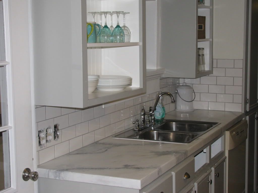

@frmrsdghtr, I hope you don't mind me grabbing your picture from that thread and pasting here. I cannot believe you made marble out of concrete! I love it!!! If you see this post, can you please share more details? What do you mean that it's an overlay? Did you just make a thin shell that sits on top of existing laminate countertop? It does not appear bulky enough for that. Do you have any staining or discoloration problem with such light colored concrete? Got any progress photos too? Did you find any book or website helpful? (Sorry for all the questions.)

Here is a follow up of that beautiful "marble" concrete countertop

Thanks eriepatch for directing me to the other thread. I'll ask questions specific to that countertop there. But hoping to see more photos from other owners. Maybe that IS the only one concrete countertop on GW! It makes me want to do it even more! :)
