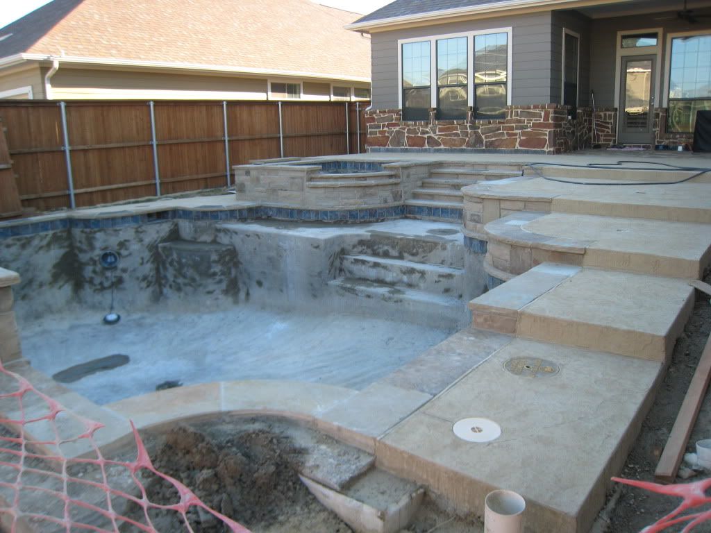

  • pooljewel_2010
    13 years ago
    We still have a little bit to go, but so unbelievably happy with the PB and progress on the pool.
  • pooljewel_2010
    13 years ago
  • pooljewel_2010
    13 years ago
    Just need the deck sealed, a few minor adjustments to stone, and some adjustment to the crystal foam jets. Still progressing nicely though.
