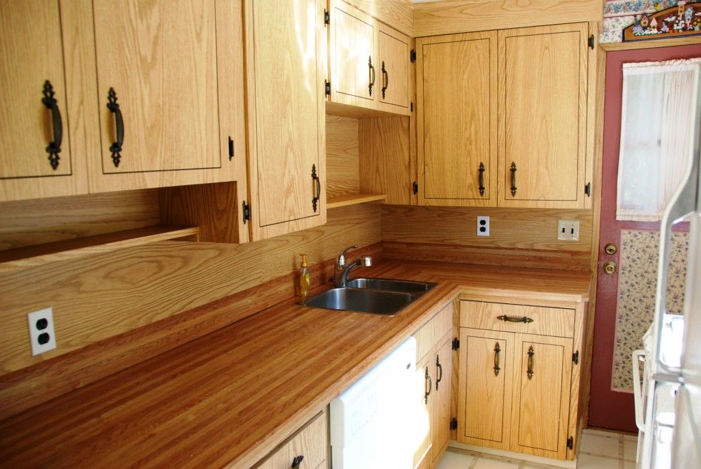

I have a small galley kitchen that I'd like to remodel with new cabinets, floor, counters and appliances. I've never done any remodeling before. I don't plan on this being a DIY project but also have a small budget for it.
I'd like some ideas about how to maximimize the storage space and work space. Aesthetically, I think I'd like the sink and range to be switched, but fear the added cost to move both water and gas lines.
Ideas/suggestions for me? I have attached a basic floorplan of the dimensions, appliances, openings as they are now.
Key points:
9 x 8 essentially
Exterior door at one end
Dining room at the other
Small bay (?) Window above range
Thank you!

    can the exterior door be closed up and a new location be created for the side entrance. So much more could be done without traffic through the kitchen and availability of 3 walls to flank with storage/counters of some sort. People could help you with designing the corners and that outside wall with perhaps even a new window...it would be great.

    Before ruling out moving your sink and range, what are you dealing with? Basement with acces, slab, crawl space? Which way do your joists run? It might be very reasonable to move them depending on how things are set up.

    For now, I have to say no to moving the door, although we are exploring the idea. I guess I'd like to explore an option where the door remains and an option where the door disappears.
    How do I add 3 more photos? I have them in photobucket, but can't figure out which link adds them to the post.
    Thank you!
  • seashine
    Williamsem, the kitchen is above a finished daylight basement. There is a finished bathroom below the kitchen. I don't know which way the joists run.

    Here are the photos of the kitchen.

    Hi. There is sunshine coming from somewhere, behind the stove, right? It seems to me that it would be so much nicer for the cook(s) if the work counter were on the window side.
    So, with the door staying where it is:
    Inside wall: Refrigerator opposite where it is now, dishwasher, and sink in a straight (not L) run to corner.
    Window side: Stove moves over, work counter under window.
    With door moved to center:
    Inside: The same as above.
    Window side: The same, but with ***almost 3' more usable space*** that could be invested pantry pullout(s) and/or work counter.
    If it's at all pretty outside, maybe a French door in the center to bring in more sunshine and add the charm of a view to those looking into the kitchen and those working there? Or perhaps just one with glass on top.
    Note that because it interferes with efficient use of the 2' of wall space in the corner corner and gets in the way of traffic, whatever else you do, IMO that little L hook on the left run by the door should go.

    What are the exact dimensions of the space?
    The length/width of each wall, window, doorway and the distances b/w each wall, window, and doorway?
    What type of ceiling do you have in your finished basement? One that you could get into easily? Or would you have to demolish part of the ceiling to access the plumbing (water and gas)?

    The door could be closed up (pending city code verification). I'd be interested in either moving it to the center of the wall if it was kept.
    There is a finished basement below, so I think between that and redoing the floor, we should be able to move plumbing around (I think/hope). I don't know which way the joists run.
    Rosie, yes, there is a window above the stove. It's a garden window and irritating except for the light it allows in. I like the idea of moving the exterior door to the center of the wall and making it a little french door. Or, alternatively, interested in the option of closing up that door and putting in a little french door where the range is. That would open up to the front yard which is enclosed like a little patio/courtyard. I also love brooklyngalley's kitchen! We can't extend into another room, unless we merge the kitchen with the dining room (a post to follow once I have a floorplan drawn). Or, I've recently become obsessed with the idea of a bump-out / cantilevered micro-addition, as a way to gain a tiny bit of extra width to the kitchen.
