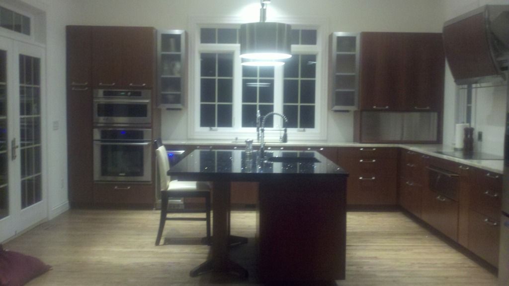

I love, love, love my counter windows. I never would have even thought of it if it wasn't for this site.
Uploaded from the Photobucket Android App

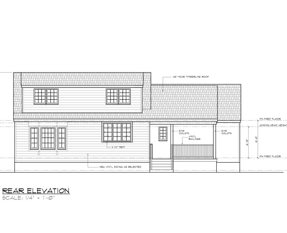

Sorry to hijack but one last post to kashmi and then I'll start a new thread--
Here is my plan. The window on the bottom left is the bay in the dining area and the one on the bottom right is the kitchen. Actually the present plan is that the kitchen window is now taller (4'). It consists of a 3' clear (no grilles) picture window with 1.5' casements (with colonial grilles) on either side. I thought have 6' of windows with grilles was too much. i wanted something more "clear" but since the other windows in the house have colonial grilles I can't change them much. The bay will also be clear in the middle with the windows on the side having grilles...

marcolo- Yes in the kitchen the casements on either side of the pic window will have cranks.
Can you read my other two threads on page one for some comments? : )
