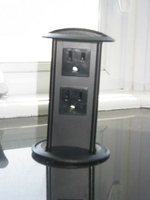

  • Buehl
    12 years ago
    Outlets - we used Mocketts to satisfy the outlet requirement. But, check to see if they are approved in your area if you consider them. We spoke with both our electrician and the County inspector b/f installing them, so we knew we would be OK.
    They recess into the counter when not in use. About the only time I use them is at Christmas for electric candle lights. The nice thing about them is that if I only need one outlet, I just lift it high enough for the top outlet.
    Mocketts up...
    Mocketts down...
    Mockett closeup...

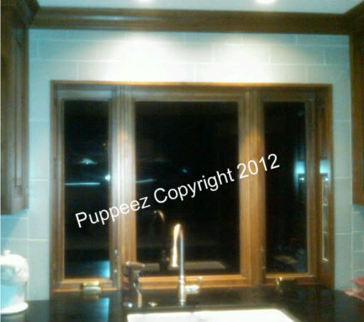

  • puppeez
    12 years ago
    Another fan of the counter height window. MMDDP was my inspiration, and I had the contractor and window person study her window carefully. I couldn't get exactly what she had, but I'm happy with what I have.
    Measure measure measure to get the right height. Check to make sure the flooring is level and/or the cabs can be shimmed to take the difference into account. And check your countertop thickness. I was told 1 1/2", but in reality it was 1 1/8".
    I trimmed the inside of the bumpout with wood, but installed the backsplash tile up and around the window. Thanks to this site for all the info people are willing to share, I got a much better kitchen.
  • la_koala
    12 years ago
    puppeez, can you share a pic of how your counter height window turned out?
    You are spot on about measure measure measure for the right height, and to check the countertop thickness. I told my GC that I wanted a 1/4 inch "reveal" of the window trim showing at the counter, but they did the trim before the cabinets arrived. I should have re-checked, but figured he knew what he was doing. After the countertops were in, it is in actual reality a 1/2 inch of trim above the counter.
    I know that doesn't sound like much, but every time I look at it, it bothers me. Especially since:
    a. I really really wanted flush, but he convinced me of the risk of water from the counter getting into the window that way), and
    b. The reveal on the sides of the windows is 1/4 inch, so the bottom ends up looking "chunkier".
    --Lee

  • puppeez
    12 years ago
    la-
    here ya go, the first pic is of the left side of the window that is about 1/8" low. I really don't notice it anymore.
    and this is the right side that is exact.
    and here it is overall, hmmm bad cell phone pics.
