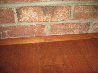

You might try something like this, especially since you don't have quarter round anywhere else in your house. This type of trim out looks a bit more attractive than the usual quarter round, I think. Our flooring installer did this, it's oak trim that we stained as well as we could to match the wood flooring.PhotobucketPhotobucket

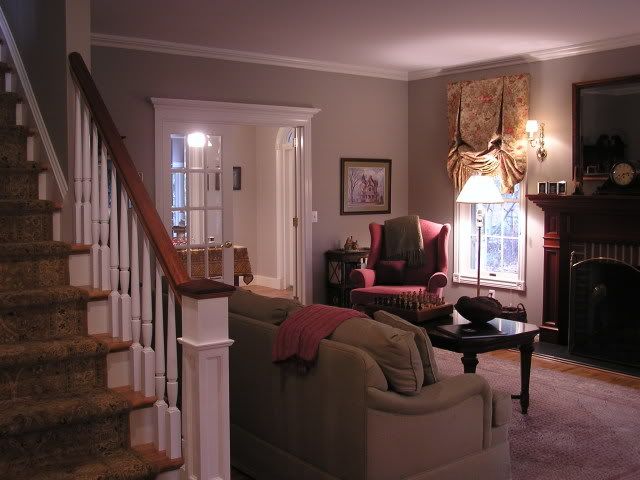

Here's a pic of our daughters living room fireplace,
the wood trim surround was cut from the flooring wood.

Okay, I took a couple more close-ups of the two moldings that we have here that are of the same bamboo as the floor. It sorta looks like the second one could be done the same way that nana2 did hers. What do you think? It's tapered so the fat part could go against the tile and the slope down to the floor.

kitchenkelly (and everyone else) should I have them maybe cut that tapered trim (I don't know what it's called) maybe in half and then do it picture frame style? I sorta need to make up my mind by tomorrow morning when they come to finish things off. I like the tapered edge, not so fat as the quarterround, so maybe that's the way to go.
