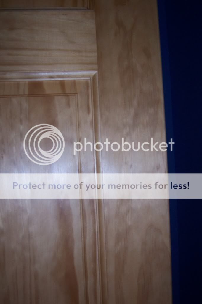

What's clear grain filler? I hope I don't have to reveneer, to veneer the edges and cut out for hinges, bolt would be even harder than reveneering the rails and stiles and cutting out for the knob again. And then what would I do with the raised panels?
Not the door I'm working on, but one of the first ones I did (just so you can see the panels)
linen door at top of stairs
Closeup
Oh, and here's a closeup of a different door - bad lighting/focus but maybe you can see the profile. I don't know how I could veneer the rails and stiles and hide the edge of the veneer.

No filler will fill the cross-grain sanding scratches to anyone's satisfaction. They have to be sanded out in the direction of the grain. On pine doors such as you pictured, the veneer is plenty thick to accomplish this. use a 150 grit paper, or better yet, a cabinet scraper. Take a class or view a video on how to sharpen and use one. So much more efficient than sandpaper.
