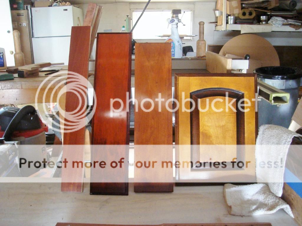

Your finishes look fantastic. We have chosen cherry for our cabinets but can't find a stain that looks red enough but not too dark. Also, everything we have tried looks very splotchy and we are starting to think we should choose another wood with a red stain. Light cherry and traditional cherry show splotches and we are going to try a natural next (all varathane). I don't know what the sanding specifics are on our samples. What techniques did you use on your smooth vs. splotchy board? The color is very nice. Do you have any feedback on our next move? Btw, I do not care for the amber/ginger tones and prefer the red tones. Thanks so much.
RE: natural cherry cabinets
Most woods splotch to some extent. If you choose cherry, splotch is a characteristic of the wood and part of what makes it beautiful. Also it will even out after some time. Look in the Stickley furniture web site, Williamsburg collection, and you will see how a cherry finish should look. The cherry finishes I have applied to kitchen cabinets are aimed at looking this good. First of all, the examples I provide to the customer are big, not little. You can't tell much from a small square. These boards and the door are examples I made for customers.
First I lightly wet the project with distilled water and after it dries, sand it down with 220 grit sandpaper. Vacuum off the dust and wipe down with clean rag (not a tack rag). I use Mohawk water based analine dye mixed to the color I want (natural cherry or mahogany or some combination) and spray on a light coat, and let it dry. If I want the color darker I spray another coat after the first one dries, and so on. After it dries, if the appearance is terribly splotchy, I would even it out with a aerosol spray from Mohawk called Ultra Classic Toner. Two to three cans would do a whole kitchen because you mist it on from far away. Never had to do this but I have used it to blend two finishes together. Finally, I use Hydrocote Resisthane Plus waterbased pre-catalyzed lacquer for the finish coat (per instructions on the can). The only time I would use an oil based stain would be the bottom of the second board where I wanted to celebrate the splotch. I've done several kitchens for a cabinet maker I sometimes work for and I can't remember when I wasn't tipped by the homeowner. The way I learned this finish and a lot of others, was I got a lot of boards and practiced. I also have made and installed my own cabinets, but only if they were a type you couldn't get off the line.
