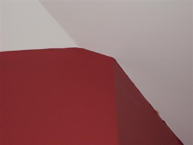

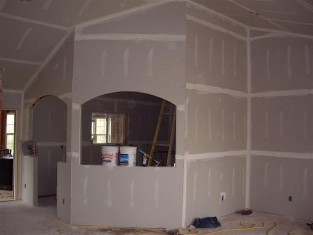

Here's a couple of pictures that show the area I am most concerned about (excuse the messy painting job....I have to do some touch-up). I am really not looking forward to even thinking about these cuts!!

There is no neat and easy way to run crown there. It would involve splitting the horizontal and vertical portions of each turn into separate transitions. Same goes for turning the main wall run into the raking run. It can be turned in steps or with blocks, but neither is preferable.
The old-time Audels-approved way was to have a different profile of crown made for the horizontals and the rakes, which would indeed miter to each other perfectly at the corners, even though they were different profiles and sizes.
It's the change of plane in two directions simultaneously that are hard to deal with. Turn any corner in one plane, fine, but add a incline angle to the mix and you're beyond what the molding can do.
