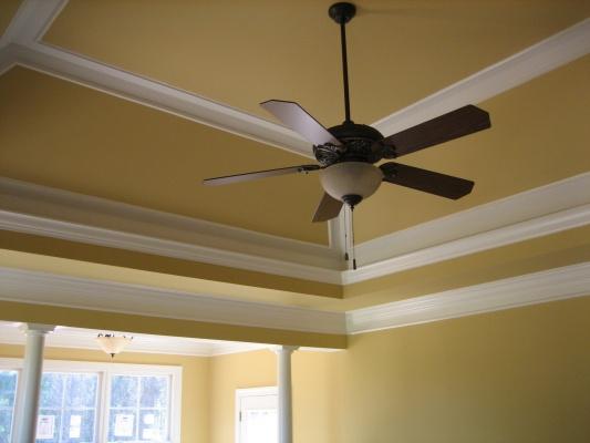

I have a MBR and an attahced sitting room...sitting room is 14 X 14 +-, with a vaulted tray ceiling..BR is 14 x 21, also with vaulted tray ceiling...I am having crown type molding placed at top of walls, with angled molding rising from all corners, then another molding around ceiling...also 2 doorways will be built out with moldings..cost 6500 beans..if anyone answers this post, i'll get the estimate and provide more detail...On the way out, i was asked how soon i might decide, and answered we are awaiting oher estimates...The gentleman soon after called me from his car to explain the workers are HIS guys,not subs, and he often "fixes" errors by other contractors..
Thoughts?
Here is a link that might be useful: Kinda like this pic

Well...adding waste you have roughly 300' of crown trim. You don't mention if it's one-piece or built-up. A 3- to 4- piece install is now 900-1200 feet of material.
Plus material for a couple of doors.
We've seen no mention of site access or photos of the room.
The bid could be way high. Or it could be reasonable. Regional prices can vary. Materials can vary. So a couple of other estimates might be in order.
Where I work, caulk is not an option. Neither if finger-joint.
I will say that with the the call from the car the guy feels he's on egg shells.
But the big variable is the level of detail or the number of pieces in the trim. Single piece versus built-up.

I might have misunderstood the original post. Based on that photo I figured it was a run of crown at the top of the tray as well as a run of crown where the walls meet the tray soffit. So essentially two runs of crown per room.
With the smaller room being 14' square, I typically get all my trim in 16' sticks. So two runs around the room is 8x16=128'.
The larger room is 14' by 21', two times around the room would be roughly 10 16' sticks, or 160'.
160+128'=288, roughly 300'. Very generous.
Casey, the "worst" room I have in my house is 9-piece crown. So yeah, if my guessing was wrong I could have "saved myself" enough material for a couple of trips around the room with that estimate eh?
