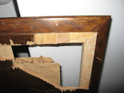

We dissected one of these doors the other night. It's definitely hollow core - solid ash frame sandwiched between two pieces of plywood with some cardboard in the middle. We actually took it in to a local store and the guy there identified it as a hollow core door. I can get a pic of the dissected door when I get home.
I was able to take off about half of the plywood in a matter of about 15 minutes with just a flathead screwdriver (to start) and a chisel. So I'm not concerned about that part at all.

Here's some pics of the dissected door:
