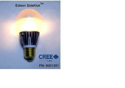

Is it possible to somehow convert these to low voltage, 10W lights? Would something like this bulb in the fixture if we were to connect the fixture to the 12-2 wire running from the transformer?

There's more info in the link below.
If that bulb won't work in the fixtures, or we can't wire the fixtures to the LV wire, does anyone have any suggestions for lights that would work for the posts.

I looked at the link you provided but those lights do not appear available - google something like "12 volt A-type LED light bulbs" to see what else you might find. I'd personally stay within 2700-3000K (maybe 3200K) color temperature to keep a warmer look - but that's me.
I didn't mean to imply 10 watts was necessary, I'm using 7 watt LED bulbs (A/C) in our post lights on our driveway gate an they could easily be dimmer - but we're in the middle of nowhere.
You could also buy some inexpensive L/V LED fixtures and maybe swap the insides around.
