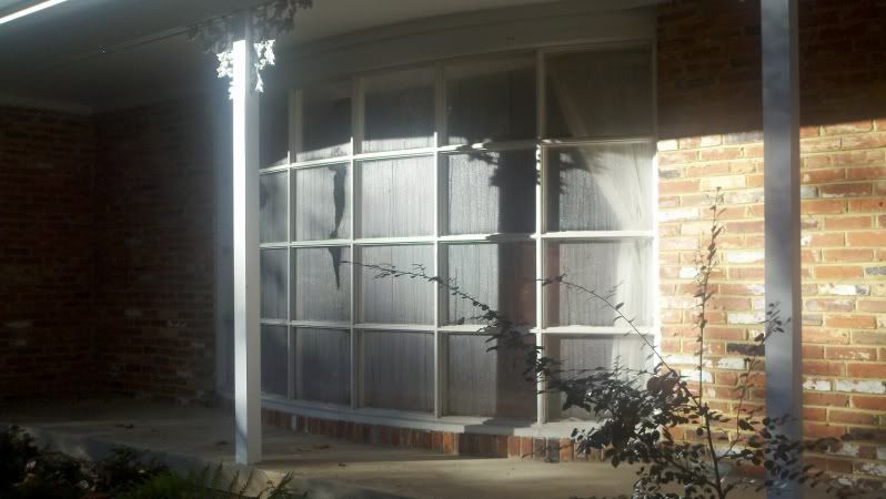

We have replaced every window in our 1960 ranch with Certainteed vinyl, except for this monster bow window. 6 feet tall and 11 feet wide. We are in Northern Virginia so we have a few snows and alot of sub-freezing weather and it's time to fix this drafty condensation monster. We're staying in this house probably 10-12 more years. 10 years ago the $7K bids were not in the budget so we've been saving to take this project on but don't know the best option. We love the light and the view. Professionals or experienced remodelers, what would you do? If possible can you add pix or photo sources so we can show a professional what we want? Thanks in advance.

First off, with a window that large I would Not be using Certainteed vinyl..Certainteed are not known for high quality windows..no offense..high quality vinyl would be Okna,, sunrise, or gorell. You install Certainteed for a bow that wide, you will have some warping and air leakage..not so with the high quality vinyl brands I mentioned.
RE: what are options for 11 foot wide bow window replacement - x-
I agree with Mmarcel. I would be looking at either a bay or bow window made by Sunrise, Okna, Gorell or Softlite. The only other viable option would be to just replace the glass in the existing or go with a flat configuration such as a casement/picture/casement. I would not recommend the latter.

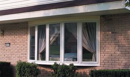

Thanks for that great advice. I have done a locate a dealer for each of the companies you recommended. What is this called..I think I'm asking what windows are combined is this layout instead of the layout we have now?
The lower windows are called Awnings and the upper windows are casements. However, you would lose the "bowing" of your existing window as this would be flat against the exterior wall.
If the two on each side were operable on this example thta I like, in my case I would need six separate windows (right?) what is it called on the sides...casement? Is this an option for something 6 ft 4 inches tall? Again I thank both of your for your advice.

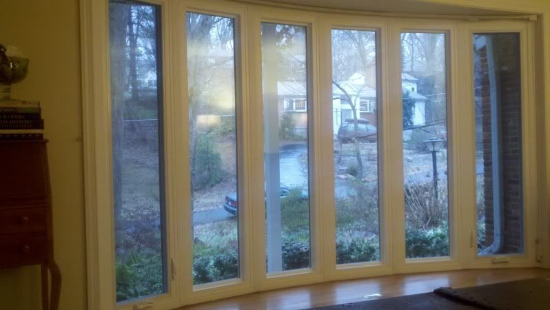

Thank you very very much for the valuable advice. We got quotes on Okna, Softlite and Sunrise. We chose Soflite and this is the Bainbridge.
Our photo below shows what to expect when the replacements have to have "more grid" and less glass than the original in a bow or picture window. This is all tempered glass so safer if someone hits it and breaks it, it is low E argon. It was inoperable before and now the 2 casements on the end are operable, and the other 4 are picture windows. Okna and Sunrise were great options too. We found the Okna product to be significantly more expensive and for our situation that level was not what we needed. Immediately we were more comfortable and warm in the room...no more drafts.
Correction: we got a Gorell quote, not Okna. It was Gorell that had a great product but more expensive than we were comfortable with for our situation.

Turned out pretty nice looking.
Good job researching and getting a good product.
