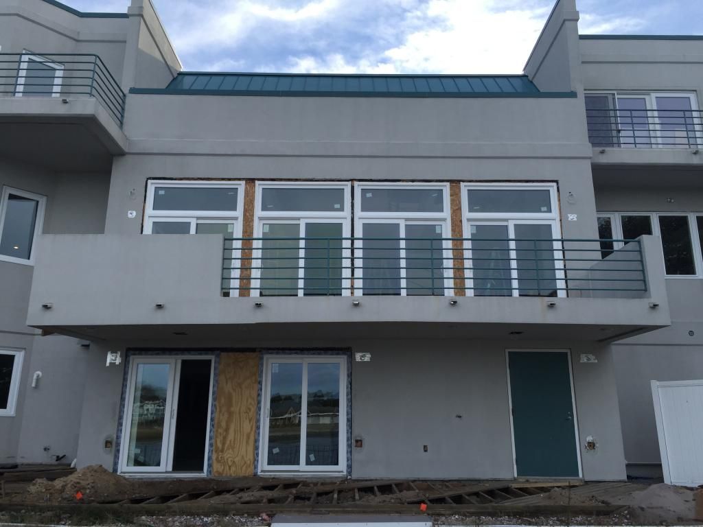

    Finally Install has begun. Between awful weather and the holidays the install kept getting pushed back further and further. They started about mid day wednesday, They took off today for new years day and are starting back up tomorrow. Both me and my foreman have been watching their work very closely and so far so good. They have caulked, and flashed nearly everything along the way. Removed all the old doors and we went down to bare slab and rebuilt a new sill, IM very happy that this isn't just the standard "caulk and walk" job. I love the doors looks so far. They are super heavy which I just put towards their quality. Cant wait to see the rest. If anybody has any suggestions or critiques to the install IM all ears.
    Heres some pics I snapped about half way done with these 2 only 9 more to go! These two doors here probably received the largest modification. This was originally a 12'6" door span with an improper header above to support the opening, the easiest way to fix this was to make them two separate 5-0 doors and build the center support to properly structure the upstairs, Before work begun with the doors I had a structural engineer out to make sure we were doing the right things.
    {{gwi:2138005}}
    {{gwi:2138006}}
    {{gwi:2138007}}
    {{gwi:2138008}}
    {{gwi:2138009}}
    {{gwi:2138010}}

  • PRO
    Windows on Washington Ltd
    9 years ago
    Looking good so far.
    Happy New Year.

    OK they seem to be following it mostly. As long as it seals I'm happy. I just wanted to be sure nothing was being done completely wrong. Looking at the videos from both suggested sources it looks like flashing went around the parameter of the window. We didn't do that, just caulk right on the nail fin then pressed up against bare plywood, then finally peal and stick rubber wrap over the fins. But to finish and trim it of course we will have tyvek over the wood before new stucco and trim is applied, and the tyvek will cover everything. The salesman didn't leave me with much comfort when he said "we never do nail fins" But I know everybody has their own way of doing things, me included. Both me and my foreman are Class A licensed as are the installers (subs of course) but we all have a different level of experience out in the field and our own opinions on how to do things.
    They got the hardest ones done today. The two 12 foot doors in the great room done. Looking good so far, House really holds in the heat well and we only have 2 of the 6 central units active right now. Feels like we could make a 7500 sqft sauna lol.
    snapped a couple quick shots today, but it was busy. this was mid morning . Much Cleaner looking. 6 down 5 more to go.
