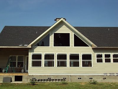

We have LOTS of windows (double paned) with 4'x6' windows in the all season room. Above those windows we have large glass windows which are commercial grade, insulated, with a special tinting (can't remember what it is).
Even so, we still get a more heat through those windows that I want in the late spring to early fall.
I suspect we will have a similar issue with the master bedroom which you will be able to see as the black roof south center of the house.

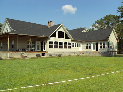

On the SW "back" of the house is a 10' porch with roof which shades the windows of that bedroom. It is significantly cooler than the all season room.
You can see the windows I am talking about in these photos:
From 2009-08-09 Shorty finished back gables & Picture Windows
The above pic is very close to the actual angle of the sun.

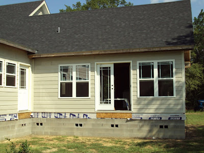

These are the master BR which receive the afternoon sun.
I have considered building a pergola to shade those windows.
I have considered building a shed roof over them.
I have considered simply getting blinds for the windows.
What do you recommend?

Sun Setter easy shade window shades. We installed them on our house in eastern washington and they significantly reduced our AC bill.
