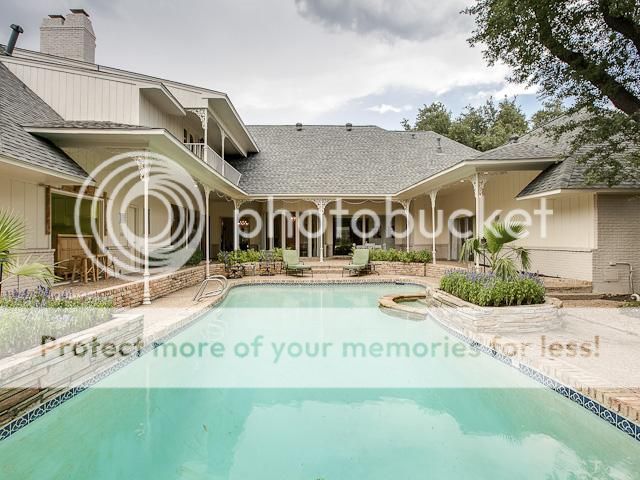

    This is the critical area on the house:

    The big windows are 6' wide by 8' tall picture windows. The two on the front are 8' wide by 6' tall. (Currently a pair of 4' x 6' single hung per-- we don't need them for ventilation)
    The tough points seem to be the 6' x 8' picture windows. Would a commercial glass guy be able to drop new tempered Low E glass in there? They wouldn't be energy star but the frames and not tempered glass that are there now have been there for 46 years...

    A commercial glass company can put a new frame in and install butted glass within the frame, if you're willing to go without Low-E coating.
    6ft x 8ft is the largest picture window that NT will make in their Twinsulator thermally-broken aluminum series.
