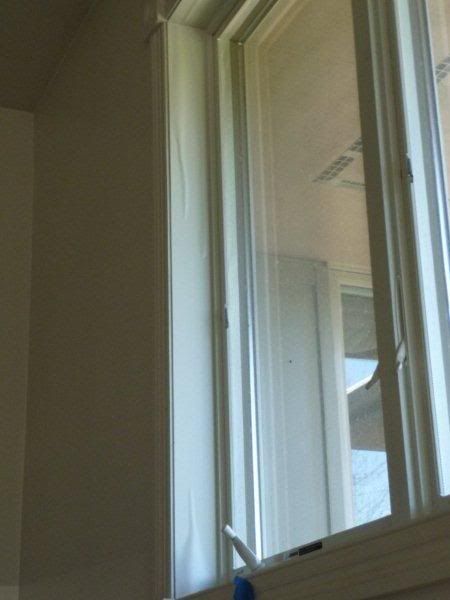

We built our house in 2005 and spent $19,000 on Andersen windows. The jambs themselves are white vinyl wrapped - seemed like a good idea at the time, but now the vinyl is bubbling on seven of the windows. The Andersen rep who came to view our problem says there is no fix. They will replace the jambs if we remove and reinstall all the window casings ourselves. I'm disappointed they won't stand behind their product 100% and cover the full cost of the fix. Anyone else have this issue? If so, what did you do?

looks as if it warped. That looks like an Andersen tilt wash. do you get alot of heat build p in that area? even so, that should never happen.

Are those vinyl or fibrex windows? They look like double casements? And the vinyl covered jamb, I'm assuming it's an Andersen sub jamb that's part of a full frame install? Otherwise, why would they replace it.
I'd kind of like a little more information.
Either way, a wood jamb painted white wouldn't do that. Andersen can't get it through their heads that vinyl and wood do not go together well. Never has, never will. Don't replace this with the same thing.

Looks like a vinyl wrapped extension jamb to me.
RE: Andersen - anyone have our problem? (Pics)
looks like contact paper to me.

Yes, they are vinyl double casements and the extension jambs are vinyl wrapped. We would like to replace them with wood so this doesn't happen again. Do you think it would do any good to try to escalate this issue at Andersen? It seems to me this is such a gross product defect, they should cover 100% of the cost of fixing this. What do you think?

That is definitely a product issue if the jamb extensions were integral and Andersen should replace them.
