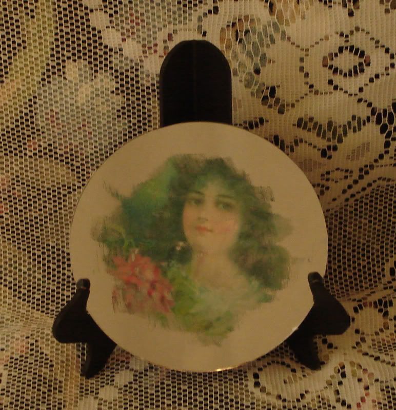

HI ALL i am new to this...i am looking for something to do for my daughter that i use to do in school ..but can't remember so i am hoping you all can help me out...we use to take a glass mirror and took some of the backing off...and then we would put a picutre on the back...and then you could see it throught the mirror...i hope you can help me out...thank you

Great suggestions for removing the silvering or mirror off the glass! It was suggested to me to use the toilet cleaner, I haven't tried that yet but plan on it. Mom629..I just made mirrors with pictures on the back. I want to try photos next. I used old makeup mirrors that cost about a dollar or two at Dollar General,which gives two mirrors.
