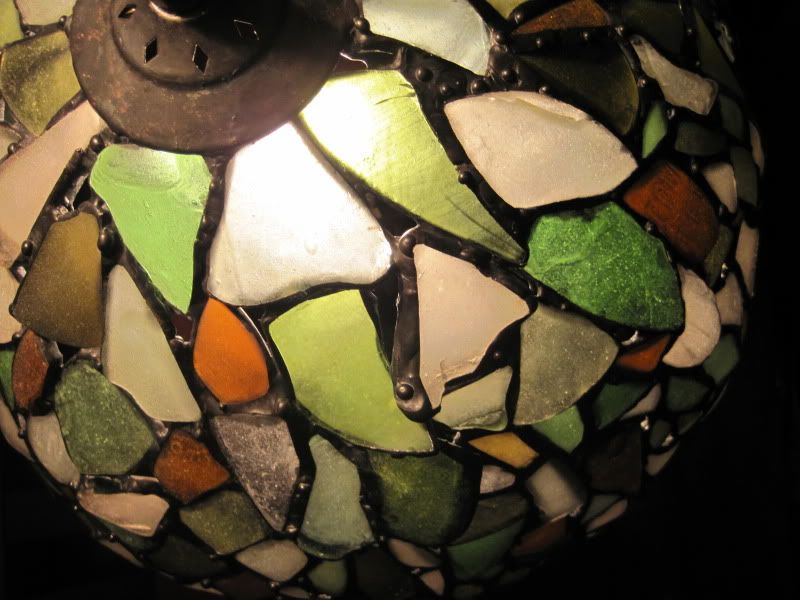

I live near the beach and started collecting sea glass a while ago, this Tiffany style lamp shade is made out of sea glass that my children and I have collected it's about 10x15 inches
Anyone that has foiled glass will understand the many hours that went in to just getting the glass ready, it was especially difficult as each piece of sea glass is different thicknesses and some are twisted or curved but this also adds to the wonderful eclectic look of the piece.
The finished shade I still need to work on the stand which is very old
sea glass tiffany style lamp
Lit up at night
You can see pieces of sea glass jutting out
Close up

deezie for the foil to stick you have to wash the sea glass really well in warm soapy water then rinse well and dry completely. Even the oil from your hands will stop it from sticking properly so if I'm foiling for a length of time I keep some methylated spirits handy and wipe the glass and my hands if it stops sticking. With the foil I have also over the years had the odd roll that was faulty and just wouldn't stick no matter what. To get the black finish you use 'black patina' this is a chemical that reacts with the solder.
Slow for the mold I used an old lamp shade I had to get started then when I was about half way I hung my shade on the lamp base and applied the glass free hand. Yes you have to foil and solder each piece of glass before you start to put it together if you don't solder the edges before you assemble your glass the copper foil will oxidize and it will eventually fall apart! what a horrible thought:(
