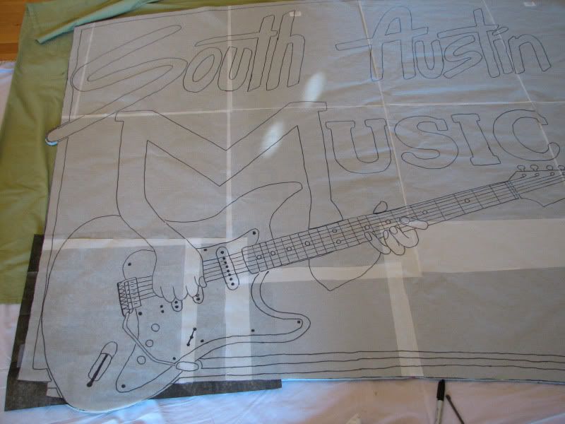

Will post pics tomorrow. Tried to get some good pics just now and there's too much glare on the sign and it's too heavy for me to move. We just cut out the Wedi today and we used an old, old sabre saw from Montgomery Wards and it worked like a charm. Had to piece the sign together out of 3 3'x5' pieces of Wedi.
RE: Need help with a mortar/thinset question
I was gone all morning so there was a glare from the afternoon sun again today by the time I got out there, but here's a picture of the sign, and the second picture is of the Wedi with my tissue paper design on top. The sign will be done in black and white stained glass, and I will probably use white grout some places and black grout other places, haven't decided yet. May use black only.

Oh wow that will be so cool!!! I'me going to start a sign for my husband..for his golfing hill.. He calls it Fenton Hill Park!!! Thought it wud be cute to have a sign.
ooo that's a cool logo
WOW - that'll be soooooooome project. Looks huuuuuuge.
