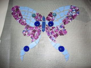

Ok this is what I have learned from others who have done mosaics this way.(my first attempt). I have my pattern on copy paper, place wax paper over it, then the mesh goes on top of wax paper. I am using mac glue. I put just a dab or two on the back of tess and then place it according to my pattern. I let my glue dry overnight then turn it over to peel off the wax paper. The glue doesn't stick to it, and the pattern is reusable. This is as far as I have gotten. I have read that you trim the mesh as close to the tess as you can get, then put your thinset on your substrate, then place your tess on it. Let thinset dry, grout and seal. Folks please step in with anything I have left out. Here are two I have finished.

KAT: You sound like a teacher - PERFECT instructions. Only thing I'd add is that when you place your screen onto the thinset, be sure and use something to press it down firmly, so that you're sure your tiles are receiving the adhesive. EMT: Using the mesh is for convenience. For example - portability - if you're making a large project and want to sit while you work and not have to stand or stoop at your project, use the mesh in small pieces - then you're able to put it all together - sorta like a patchwork quilt, so to speak. KAT - very pretty projects, I might add. I've had a lizard ready to grout for ages. Sure like yours and the butterfly.

Thanks for the pictures. It always helps to have a visuable aid when your new to a new hobby.
