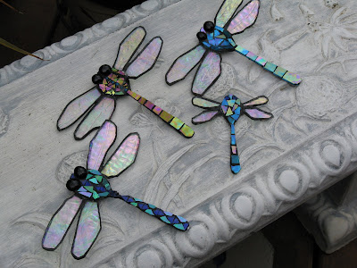

emtnest, you look to be doing fine to me. You might try a narrower foil. I resisted the narrow foil at first, but it really does look nice when you are done.
Black patina would look nice on the nails, I don't know what it would do to the spoon. You could try it and see, maybe on an edge of a spoon. That way, you would be covering it with foil, and it could be covered up, if it didn't look right. You can check the black patina out at this site.

Emtnest, Let me know what type of flux, what size tip and what size iron you're using. Soldering takes so much practice and there are so many factors involved. Be sure you are using plenty of flux (I know you're not supposed to use so much that it spits at ya, but sometimes I do!).
Have you thought about using a u-came on the wings? You would still have the issue where the wings attach to the spoon. This butterfly was made using the u-came. As you can see, where the wings attach to each other, the solder's not completely smooth but the border around the wings are perfect due to the came. You can even now get lead free came.

Oh thank you for your interest Chinatreasures...
Solder iron is 80 watt Weller
Solder tip is 5/8"
Solder is Cantfield Solder-mate 11
Will have to see if they carry the u-came where I get supplies. Yours looks so perfect around the wings. Is that u-came a solder? and, will it take a patina?
Someone else suggested doing a black patina, will be looking for that too.

Emtnest, to try to answer your questions, here goes:
Here is a link to the u-came: http://www.glasscrafters.biz/Merchant2/graphics/en-US/gc/_6/6125l.jpg
It is a solid, very maleable material that's shaped (sorta) like a u. You would put your glass in the u part (very hard to describe). Traditionally, you would cut it to length with a lead cutter, but I just use wire cutters. Then after wrapping it around the edges of the glass (just as if it were foil) you would butt the edges to each other and solder together or, like my butterfly, I didn't wrap the glass entirely but rather put the edges of the glass into the H came that I used for the body and soldered the edges of the U came to the H came. OMG, this sounds sooooo confusing.
As far as your soldering tools and materials go, I use a 100 watt iron so you may not be getting enough heat to get a good bead. If possible, see if you can get a 800 deg tip to put in your iron. You also might get a thinner tip to have more control over your soldering. I use a 1/4" tip almost all the time, but that's because I also do decorative soldering with it and am too lazy to switch them out!
On this last dragonfly, did you solder directly to the spoon? It doesn't look like the spoon head is foiled.
