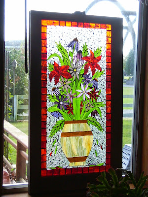

Addiesue, your windows are gorgeous!! Love the detail and flowers and just everything! Thanks for all your tips, I've done about 5 gog windows and cleaning up the glue is my least favorite part, scraping with an exacto knife takes days. I've had some bad silicone, I buy tubes of marine silicone and a couple had little hard pieces in the glue, like little tiny pebbles under your glass......so frustrating! I pay good money for that stuff, next time I'm taking it back! I've got to get one of those wire brushes....thanks for that tip. Seeing yours has inspired me to do another one, I have an 8 paned one waiting for inspiration. Here's my favorite window.

From Mosaics
RE: 2 GOG Windows Finally Finished
Oh Squirrelly! Love it! I too have had bad Marine silicone!!! I'm squeezing like the dickens trying to get it out of the tub, then taking the "rocks" out!lol! But I just love that marine silicone as it dries sooo fast!

Thanks for the compliments everyone!!....and squirrelly, that window ABSOLUTELY takes my breath away! Your's looks more detailed than mine and just blows me away with all those beautiful colors. Your barrel vase looks so PERFECT too. I'm lousy when it comes to precision so that's why I think I love doing flowers and leafs because nature isn't precise. I can see why that window is your favorite....I can hardly stop looking at it...lol. As my daughter would say...."SWEEEEET PIECE A CANDY!"
