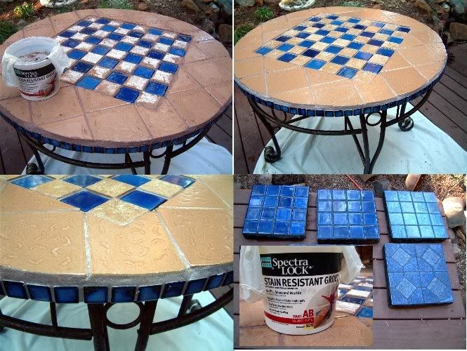

I did my checkerboard table with the backerboard. Screwed it right to the wood. You do have to sink the screws and they make special screws for backerboard. It is for sure the way to go. If you want a grout that will last forever then use Lowes Spectra Lock system.It seals itself and is stain resistant. It's also pricey but well worth it.
