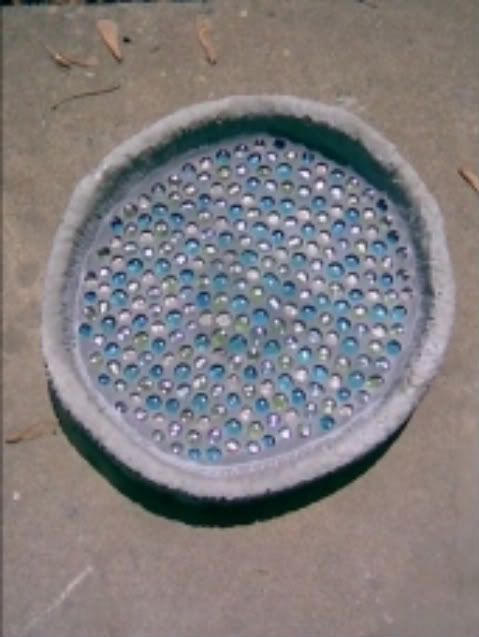

Ok, the grout is done. And I'm pretty pleased with how it turned out, especially since this is my first try at it. Now I just have to give it a few days to cure, and the birds can have it back.

GOOD JOB!!! Looks Great! How fun is that!! You'll be mosaicing Everything now!!! ha!
RE: Grouting today - need specific mixing help...
there ya go! that looks great. nothing to it huh?
Wow, that turned out sooooo pretty! I bet those globs will be all sparkly and blingy out in the sun! Great job!
