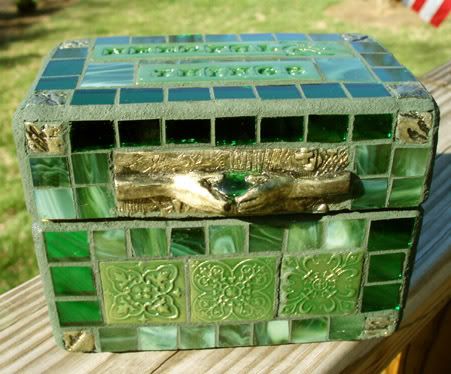

    FYI, I only ever buy white and black grouts and make all my own colors from those. Adding powdered colorant to black grout can make some great saturated tones and gets you out of the pastel ranges.
    for instance, here is plum added to black
    and this has green added to black

    Nice! Thanks for those pictures of the grout using blacks and colors. I wouldn't have thought of that, and I love the result. Do you use powdered colorants? Do you ever still use acrylics?
