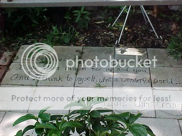

    I think I just found what I am looking for but way too expensive!!! I want to copy one of our Forum Friends. They wrote the first verse to "What a wonderful World" by Louis Armstrong on concrete step blocks. It was written somehow on the concrete. I was thinking that I might do step stones and use block lettering.

    Here is the reason for my inspiration. This patio brought tears to my eyes. Who ever did this had a charming idea!! I thought I would use mosaic letters to do mine. Susie

    If I wanted to do that project, I would make a mold for the stepping stones. I made a mold for a concrete mirror for my patio, using a piece of plywood, and building a box around it. Then I'd pour the concrete mix in the mold, and just b/f it is completely cured, I'd carve out the letters. It appears that was the technique used above. I'd use the dark liquid charcoal gray colorant that Lowes sells to color concrete, and w/a brush color in the lettering. It's an easy process, but a little time consuming. If you don't have access to materials to build your mold, you can use pizza boxes. I'm sure your local pizza store w/sell you a few. Great idea. You could also mosaic the lettering. You are right - those letters are way too expensive for a large project. DFW huh? My DD lives in Carrollton. How far away are you from there?

    I forgot to tell you to put some kind of wire between two pours into your mold. I'm sure you'll research the materials etc., but to keep your steppers from breaking, they must be reinforced. Hardware cloth or the diamond-shaped mesh is what I'm thinking. Pour half full, then a layer of mesh and fill it up. W/be anxiously awaiting some WIPs.
