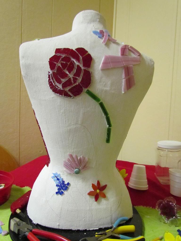

I have had this styro bust for quite some time. Drug it out yesterday to start on it. Think I should have asked questions or done more research before I started!!! I have so far covered about half of it with strips of fiberglass mesh from the building supply store and thinly mixed thinset mortar. Have I totally done the wrong thing or should I continue? On the curved areas I have little jagged edges sticking out this morning. IF I can continue would it be suggested that I coat the entire piece again with another thin coat of thinset to smooth it out more? Thanks for any guidance you care to share.

    Day 2 She's all coated. Will probably have to give another thin coat tomorrow to fill in a few of the mesh holes that didn't get totally coated, I suppose that is what I need to do !?!?!? Any other thoughts as to the work you see so far and advise is welcomed! First time to try this wrapping stuff so I'm feeling my way thru it.
  • wackyweeder
    Def needs more thinset. I put it on to the point there is no mesh showing at all.
    and when the thinset is set but still "green" you can sand and smooth and make a beautiful surface to mosaic on.

    OK.... need advise again. I have it coated real good with thinset and am going let it cure real good until next week, no time this week to work on it. Being this will be outdoors am I to attach my tess with thinset or GEII Silicone or something else?? I was thinking thinset but need ya'lls wonderful advise again! It will NOT be in a covered area, it will be exposed to all the elements. And just as well ask now! Suggestions for grout for when I get to that point. I have Mapei and I have admix Will that be sufficient or is their a better choice? I am keeping a log of what I'm doing and hoping I won't have to ask so many questions in the future! THANKS
  • silvamae
    I can only tell you what I've done and what worked for me. I have a GOG totem that's been outside in the elements for over 4 years. I used GE Silicone 2 for the adhesive and thinset for the grout.

    I've only used thinset on all mosaics outside, except on a couple of glass totems, on which I used GE II. I use as an example of how strong Mapei thinset is, the concrete rooster I mosaiced w/stained glass for my Bro down in Louisiana. When the Ouachita River overflowed it's banks a few yrs. back, his rooster was under water for nearly two months. When I scrubed all the mud and gunk off, after the water went down, not one piece of glass fell off. If you use Mapei, there's no need for the admix. It already has the polymer added to the powder mix.

    thanks for advise So I take it with the mannequin being coated in thinset it's OK to use thinset for the adhesive. Will start attaching tess next week! Slow when I got started you advised me to use Mapei and that's all I have used. A friend argues that anything will "do" but she has had to put multiple things out to the trash man as her tess falls off after a short period of time. Other than the squirrel feeders I did when I first started everything has held. My mistake there was I adhered to wood which I've learned is not do-able and one time to PVC pipe which I should have used GEII. She gets mad at me b/c I always tell her "But the girls on the forum said..........." and ya'lls advise is what I always follow!!!! I really have learned soooo much from all of you!

  • oldcrafty
    Well she won't be ready to grace my garden for Easter as I had hoped but she is "getting dressed". It's been a real fun project to work on.

  • oldcrafty
    9 years ago
    I have made a LITTLE progress, working on the back now. It really won't ever be seen because of where she will be placed, so I'm basically using up scraps and making flowers and such to "tattoo" her back. The big pink ribbon is for myself and the smaller ribbon with wings is my Mom who has lost the battle and has flown away.
