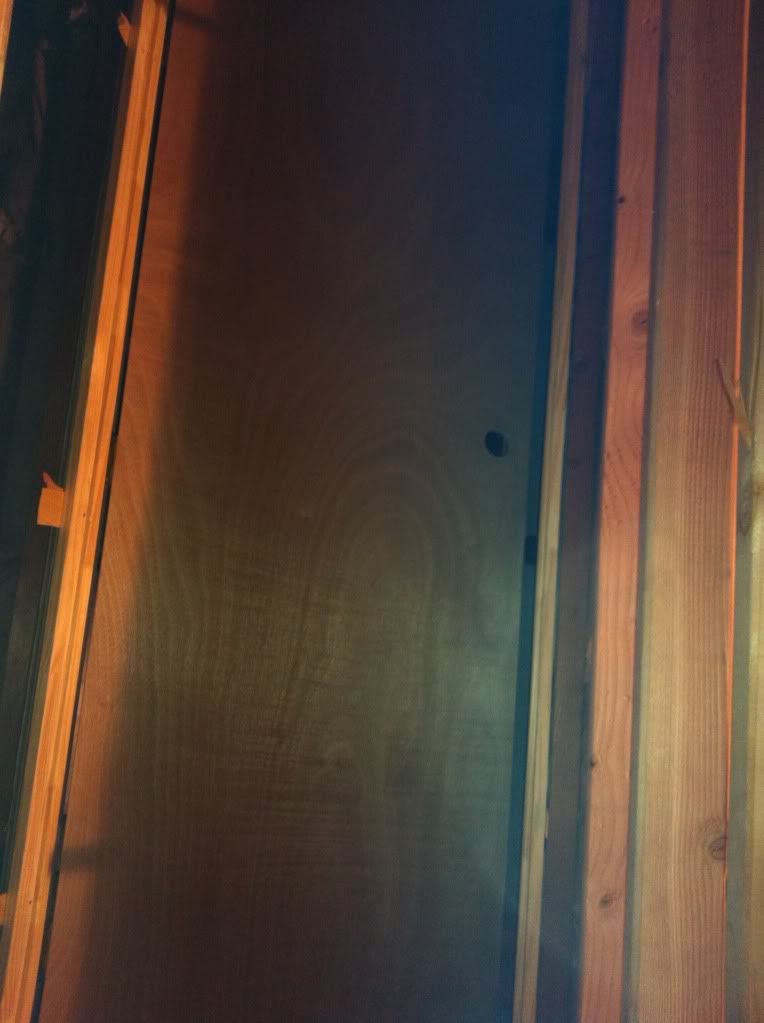

I just wanted to say a million thanks to all of you. I was able to get the door framed out today after work. i attached a picture hope it works. sorry the lighting is horrible in there. that's the next thing I will be ding, installing an overheard light. hope that's something i can also tackle myself
RE: framing a door. is this a load bearing wall
Looks good, from what I can see. But most importantly, it makes the room function the way you want.
