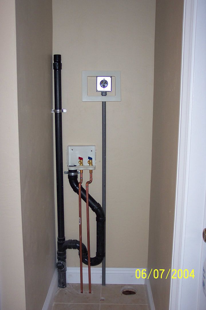

I have a stackable Bosch. I am 5'3" and do not mind bending down to unload and load clothes. We actually did not have room for a bigger set. We cleaned removed the doors a a closet and put plumbing in. WE placed a pull out shelf between the washer and dryer so we are able to fold clothes there. Our house is so small, we would have had to put it outside if not in this closet. Here is a picture.
