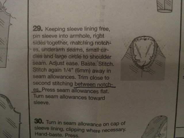

My jacket was fully lined. The arm had one seam. After sewing the lining to the sleeve, I then sewed the sleeve to the jacket.
Below is a portion of the sewing instructions.
-Laurie
The white fabric is the underlined fashion fabric. The light blue fabric is the lining.
