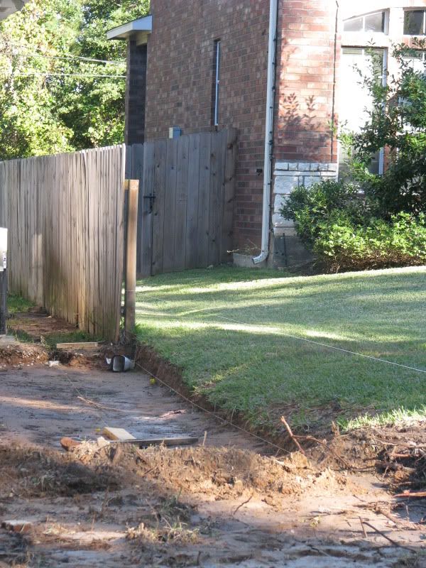

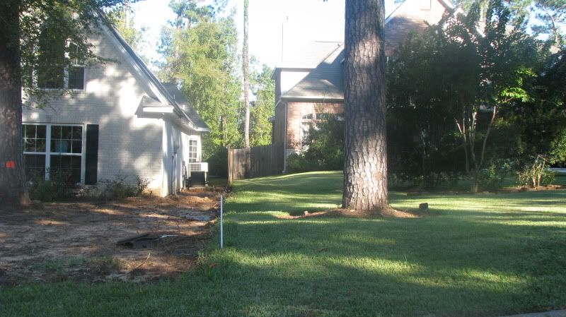

hi, i just wanted to post some pictures so you can see what I am talking about. My house is on the left side in the pictures. Half the poeple I talk to tell me to just fix this on my own and the other half tell me it is partially my neighbors responsibility. I honestly dont know what to think at this point. One of the things that bothers me is that it really looks like my fence is being used to hold up their soil level, maybe i should just remove the fence

The only issue I can see with the fence is that the bottom part of the fence that is in contact with the soil will probably deteriorate from rotting. If it were me, I wouldn't remove the fence, I'd simply use a circular saw to take out the bottom 4" or so to make the bottom of the fence just a little higher than the height of the neighbor's soil. That is not that much of a difference in elevation levels, and if you remove the bottom few inches of fencing, it doesn't look like the neighbor's yard will do anything. After you get your drainage issue fixed, simply put a little berm on your side for a gradual transition between the two soil levels, and plant flowers there.

A concrete contractor friend told me about a similar situation they had in a house they once owned where he formed and poured a concrete "ditch" and diverted it out to the street. Your picture reminded me of that story. I also remember concrete diversions on our street growing up in San Diego as we lived on a cul-de- sac on a steep hill. It's just a simple concrete base with curbs each side to allow the water to be directed. If you have experience with concrete projects, you could D.I.Y., or get estimates as I would think it wouldn't be too pricy a project.

It appears that the yard slopes down towards the back, from where the photos were taken.
Google "swale" - it doesn't probably even need to be a concrete swale, as sierraeast mentioned.
I'm not reading anything in the original post suggesting that the water is IN the house or that the uphill neighbor is being uncooperative. (Though lwayer contact imples an unwilling neighbor, it may have been preemptive.) It might help to clarify these two things. Also, a "slab" makes little sense, so something may be getting lost in translation.
Hooking solid drain tubing to the downspouts would obviously help. The tubing can be buried and terminated in a french drain or just ended above ground in the back yard at some distance from the house.
