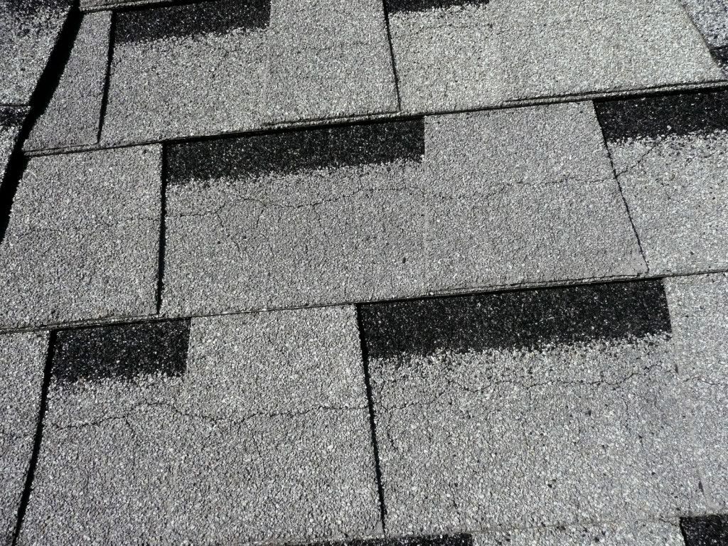

We sent the picture below to OC and they agreed we had a valid claim. We mailed the section of the roof and a whole bunch of information and photos to them Friday. This roof will cost $12-$15k to replace and no way I will get stuck with the bulk of it when we only got a third of the expected life from it.
Owens Corning Oakridge Shadow 40 year shingles cracking after 14 years

Well, we just received a pathetic settlement check in the mail that we have no intentions of cashing. We are getting an estimate on replace about 40 squares of shingles including tear off but I can only imagine that we are talking 12k at least. And their check was a bit over 3k. No way.
Has anyone been involved in a roofing warranty claim? There is a class action suit against OC regarding these very shingles but that could drag on forever. I have left vm for the lawyer in Washington DC handling the suit plus I am completely willing to contact consumer advocates on every major tv channel in Detroit and Toledo.
It would be nice to know that they always make a lowball offer hoping the person will accept it but there is more money to be negotiated.

The install labor is never part of a warranty. The materials are warrantied, and if found to be defective, they are refunded at a pro rated amount. You had 35% of the expected wear life, therefore you are being refunded for the 65% remainder of the wear life that did not occur. Yes, the costs are based on the purchased price, not the replacement price. THe check you received was accurate based on the warranty that they gave you. You are free to seek redress with a lawyer or in any other way, but unfortunately it will end up costing you your settlement check plus a lot more. You might have better luck talking with OC directly about simply giving you new shingles, but since that isn't part of the warranty, it's a crap shoot. Talking to a lawyer wouldn't even get you that, as they'd cease all communication directly with you.
