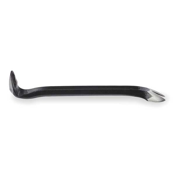

    I'm surprised she hasn't stripped the screw by now. Has she tried prying it out with a nail remover?

    One step further. Grab the top of the screw with some vise-grips. Then put a pry bar under the screwhead. Apply pressure to pry the screw out and at the same time turn it with the vise-grips and see if it backs out. It sound like screws were set into anchors in the brick and the anchor for that screw is spinning but won't pop out. Not knowing what type of anchor it is, it's unclear how big a hole it will make if forced out.
    good luck.
