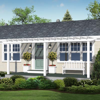

The main debate in the house is do we just added wider steps with rails (similar to what is already there, just wider), or a front porch/deck that spans the space with room for a chair or bench (like the attached picture...but even that's not quite it)

The inspiration pic you posted is a porch with a roof, but I don't see that you have enough headroom for a roof. So you'd be looking at some sort of deck type area, but then you would be limited to putting chairs only on the deck area...probably so narrow that you could only have the chairs face out, as in your picture. Or as in this one with a pergola.
If instead you build just steps to the front door, then you can build a patio at ground level which could include a seating area large enough for people to gather perhaps putting a fire pit in the middle.
Or if you don't want to use the area for seating, you can still dress it up with plantings or a fountain.

Annie - Now I see what you're saying :) We are thinking more of a decorative bench, chair, etc., not an actual seating or gathering area. Sorry, I should have clarified that better. If we can't do a true roof (which from what I'm gathering is going to be difficult) I do like the look of the pergola. Honestly my inspiration is a portico but I've been told that it isn't possible with the roof line...maybe I need further opinions.
