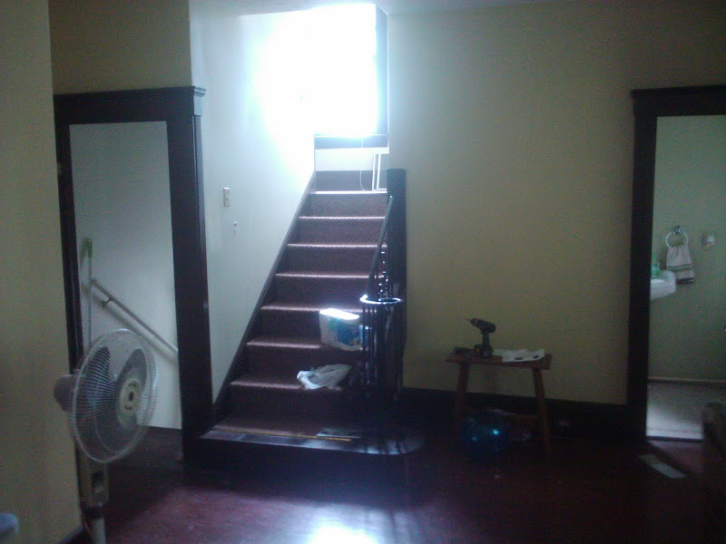

I don't know how much this will help you, but we have a house from 1910. The bottom stair is all wood and comes out at a flair to one side, but the rest of the stairs are carpet. I think it looks very nice and I would recommend you to do it. It seems like it's something you would really like to do.
It's one of those little things that ends up really making a big difference.
Here's a pic of the staircase and you can see the bottom step how it's half carpet/half wood. It looks nice. It's a little hard to see. Please excuse the mess, we were doing some stuff around the house!
From 2010-07-19
RE: Hybrid Carpet/Hardwood Stairs
thank you so much for taking the time to post a photo! I think I will go ahead with the wood bottom step. I think it might lead me to rip out the rest but we'll see. I also recently read about the step recover-veneer things that you dont have to take the step out and just cover over with hardwood. Seemed sort of interesting...
