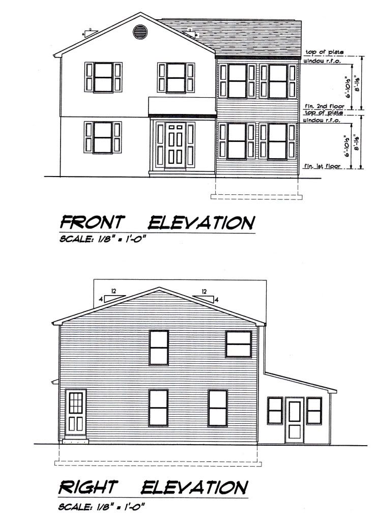

Here are the plans. The elevations:
Elevations>

RE: Is anyone interested in a weekly addition update?
I am also interested. I love this stuff!
Hope you don't mind my saying, but both I think both the mudroom and the master bathroom could be designed a bit better. The mudroom is small. I assume you wanted to see out a front window. However, you are leaving some wasted space there.
A 5 foot vanity is rarely long enough for two sinks and the entry door will probably always be in the way. Your bedroom is 19 feet long. You could borrow some to make your bathroom more functional.
Will your contractor give you time to rethink these?
There's really no other place to put the mudroom. And it's actually less of a mudroom than a storage area for all the kid stuff that accumulates on the front porch. We had to call it a mudroom rather than a storage closet to satisfy the township.
So it will be less of an entrance and more of a closet. We didn't want it in the back because our pool is back there and there's a fence around it that goes right up to the partway along the wall. So we had to put it in the front so that we can get to it when the gate is locked. And the little nook beside it is where my husband's treadmill goes. That way it's somewhat out of the way in the rest of the room, but the space will be used.
And you're probably right about the bathroom - I've been thinking along those lines myself and we do still have some time.
