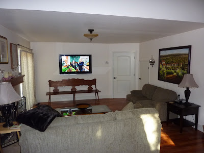

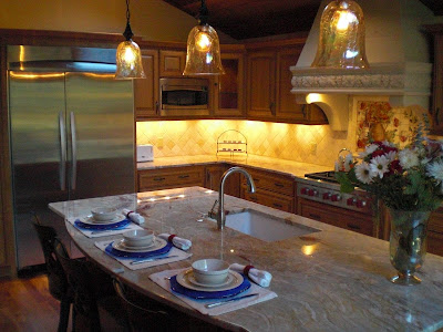

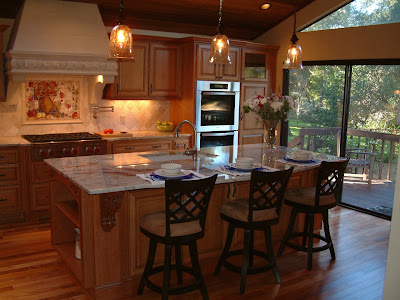

Are you looking for more seating than in your plan now. If not, it would easily work and be fairly similar to what we have. You will need to turn around the kitchen and put in a door to the dining room. Here's what we ended up with (You would have a larger family room)
View from Family Room
View from Kitchen to Family Room
RE: Egads! Not completely satisfied with kitchen floorplan.
Salmon- Beautiful kitchen! I'm thinking of doing something similar, by opening up the kitchen to the living room. How do you like having the island all one level? I've thought about raising the seating side, to hide some clutter, but I really like the way yours looks :)

Hi weedy! Did you see the new front door we got? Have to work on the walls this weekend and get the trim on but it came our great.
Lavendar, we had a split level island prior and much prefer the single level. You can spread out. We have a deep single tub sink that "hides" when we need it to
