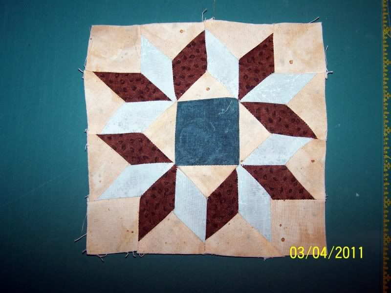

As most do I press to the dark when possible, nest seams if I can, press open for Y seams but I had a problem today with one of my Sylvia's blocks that I had LOTS of difficulty with (6 1/2"). I wont show the back as I am ashamed of it and have to admit I am not very proud of any of it but thought maybe there would be some suggestions as to pressing. JaynePhotobucket

Just thought of something from one of the hints that might help. AFTER I sew them together why not put a pin facing the direction the seam was pressed. That would help a bit. Thanks for all the thoughts
