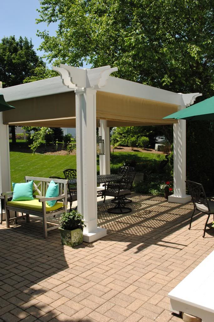

OK - you've convinced me...Sink the posts first...but i'm going for a design where the post needs to be precision cut on top.. and my carpenter can't start the project for another 3 weeks. can I build an open top wooden box and sink that into the hole as a sleeve for the pergola? Then i would fill in the base rock and DG around it...not sure if that would work...here's a photo of the pergola design that i'm trying to replicate. I'm not even sure about the dimensions of the post...
RE: how 2 sink pergola posts into DG patio without making a mess?
Very attractive.
What is the rush? 3 weeks is nothing. There are several critical placements in your design aside from the height. Let the carpenter dig and build, then install the granite surface - excavate for the fill, no more as annz suggests.
That's my suggestion because if you miscalculate anything, the correction might take even more time and cost $$$'s. I'm a DIY'er and often learn on the project but I never have anyone to blame but myself when I error.
