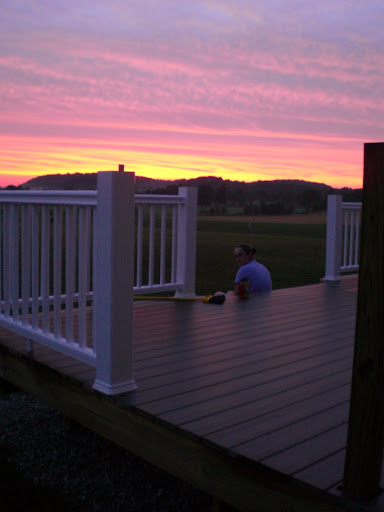

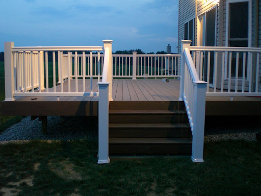

thought i'd post some pictures of the deck my wife & i are building on our central ohio home. used this forum quite a bit in making our decision (went back and forth b/w composite brands & IPE) & found the information very valuable here - just wish there were more pictures to view. so i'm returning what i can in hopes to help others. NOT, repeat, NOT trying to say that our decision to go composite is right for anyone, versus another. we weighed all the factors, found a composite that we found appealing to the eye and had a good track record. we're pleased with our choice to this point (not done, but some nice results thus far) & love the look the 'concealoc' system by Timbertech allows.
this is the first major project we've taken on of this size/magnitude/$$ - so please be gentle with comments!!

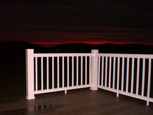

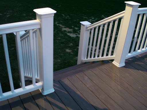

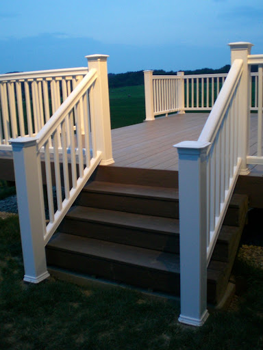

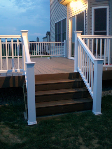

RE: Timbertech Earthwood - Tropical Walnut + RadianceRail
wanted to update my post as i've nearly completed the Timbertech RadianceRail (Coastal White) railings and a few of the users showed interest in seeing some photos. The railing is a snap to put up - i'm no expert, believe me. Even with some odd measurements/lengths it has been quite simple. We haven't decided about post caps yet, though we're considering the 'De-kor' brand (www.de-kor.com) as it states on their site they will fit perfectly on the RadianceRail post sleeves. The RadianceRail material cuts cleanly with a finish (80 tooth) blade and is super sturdy. The only complaint would be that the screws in the kits are driven using a T20 TORX bit and we've gone through 3 bits, stripping the knuckles on each. The TORX type screws is simply a poor system in my opinion - the first time i've ever seen it - hopefully the last! Any others have similar experiences? Hopefully not.
I've attached a few pictures taken yesterday, ~25 minutes after a severe line of storms hit Central Ohio. The sunset following was quite brilliant (my pups thought so anyhow!). I realize the lighting for the pictures isn't optimal, but that is all i have at the moment. If any users would like some better pictures, please respond and i'll get on it!
Again, my hopes are to assist others who may be considering the Timbertech system. Next, it's the stairs - after a small concrete pad is layed. I'll update as things change, if there's interest.

Hey Lane -
I am in the process of doing my Radiance Rail....and had a quick question...
The straight deck rails were piece of cake to put up....the stair rail on the other hand has been quite a bear.
My question is this:
Do you find that the spindles/balusters on the stair rail have a tendency to not be as tight/snug as the spindles/balusters on the straight deck rail?
The spindles on the deck rail go into the channel in the support rail, while the stair spindles (because you have to rotate the support rail 90 degrees) just sit on the support rail....
The channel on the top support rail on the deck prevents the spindle from spinning....but because you spin the top support rail 90 degrees for the stairs you lose this feature...
It seems no matter how much we tighten down the screws in the ends of the balusters, they still are a bit loose. You can spin the spindle with your hand. And sometimes if we try to tighten a bit more, the balusters split at the end.
Any insight on this? Did you experience the same thing?
Any other tips for doing the rail?
I hope my question/problem makes sense.....Thanks.
Just as an aside.....the angle we are using on the stairs is 38 degrees.

RE: Timbertech Earthwood Decking- Tropical Walnut + PICTURES!
Jersey Guy -
The instructions call for the support rail to be rotated 90 degrees on stair applications. It even says it at the beginning of the video you linked.
If you don't rotate it, the support bloocks and mounting blocks won't work.
Rotating the support rail was a bit odd if you ask me....you lose the channel that holds onto the spindles so nicely (and covers up any gaps between the support rail and the spindle).
I ended up using some PL construction adhesive. I put some of the adhesive on the bottom of the spindle and on the screw. I let the spindles set up over night......the next morning the spindles were nice and strong.
Now I just got to fix the gap on my second stair rail.....I posted that issue on a nother thread.....

pictures finally! just need a railing now. click on the linlk
Here is a link that might be useful: deck
