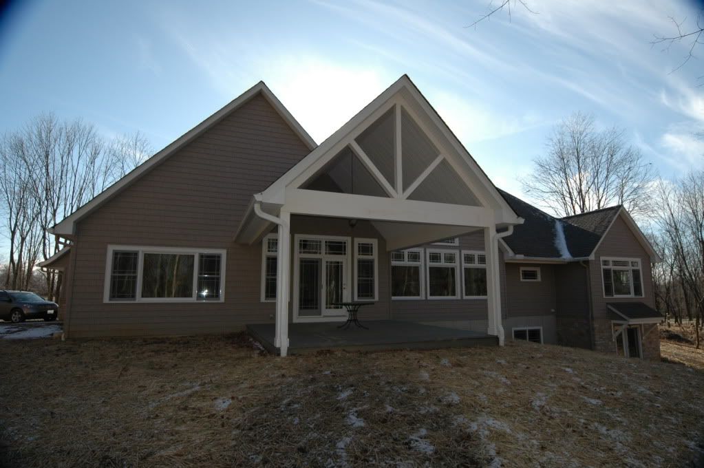

You can add a gable roof to the deck. But you would most likely need to put the posts outside of the existing deck to be sure pier /post sizes are large enough to carry the roof loads. Some similar examples I have done below.
Rear view

Well, as bigkahuna said, we have found that we have to put the support posts outside the existing deck. Apprently if we don't, it's considered changing the integrity of the original deck and if we do that, we would have to take up all existing decking and add hurricane clips and other such things to get the deck to current code. It may not look it from the picture, but this deck is extremely sturdy and isn't going anywhere. A lot of our neighbors have had trouble with the county zoning board on these things so we figure we'd just do what they say and eliminate any problems. We were going to do the job ourselves, but our neighbor runs a construction crew that's not doing anything now and says he'll give us a good price. We really like the idea of letting the pros figure out how to tie the roof new roof into the existing overhang and these guys are young and could use the work. So for the first time DH says give them the job. I'm getting excited!
