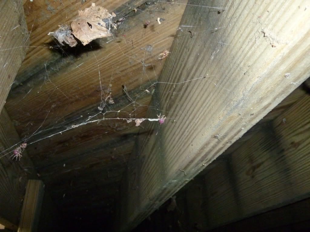

Post pics of the guts of the deck. Crawl underneath and take photos of all the framing. How joists are attached to ledger, joists to beams, beams to posts, posts to ground, etc. And a couple overall pics.
RE: are existing joists for a new deck acceptable???
My back had some surgery so I couldn't get entirely underneath, but here are some shots from the opening. I hope they answer some questions.

The posts are on steel bases on concrete. That's good. (sunk into the ground or wood on concrete=bad). The one looks like it's up off the post base, though, which isn't good. Needs to be replaced or re-nailed.
Posts are 4x4; 6x6 is current code, but these are so short, it's probably not a big deal.
I can't tell from the photo if the beams are resting on top of the posts, or sandwiching them. They should be on top.
Also can't see where the joists connect to the rim joist. They should have joist hangers, not just be nailed. Hurricane ties from the joists to the beam(s) is a good idea too.
Got some overall pics?
