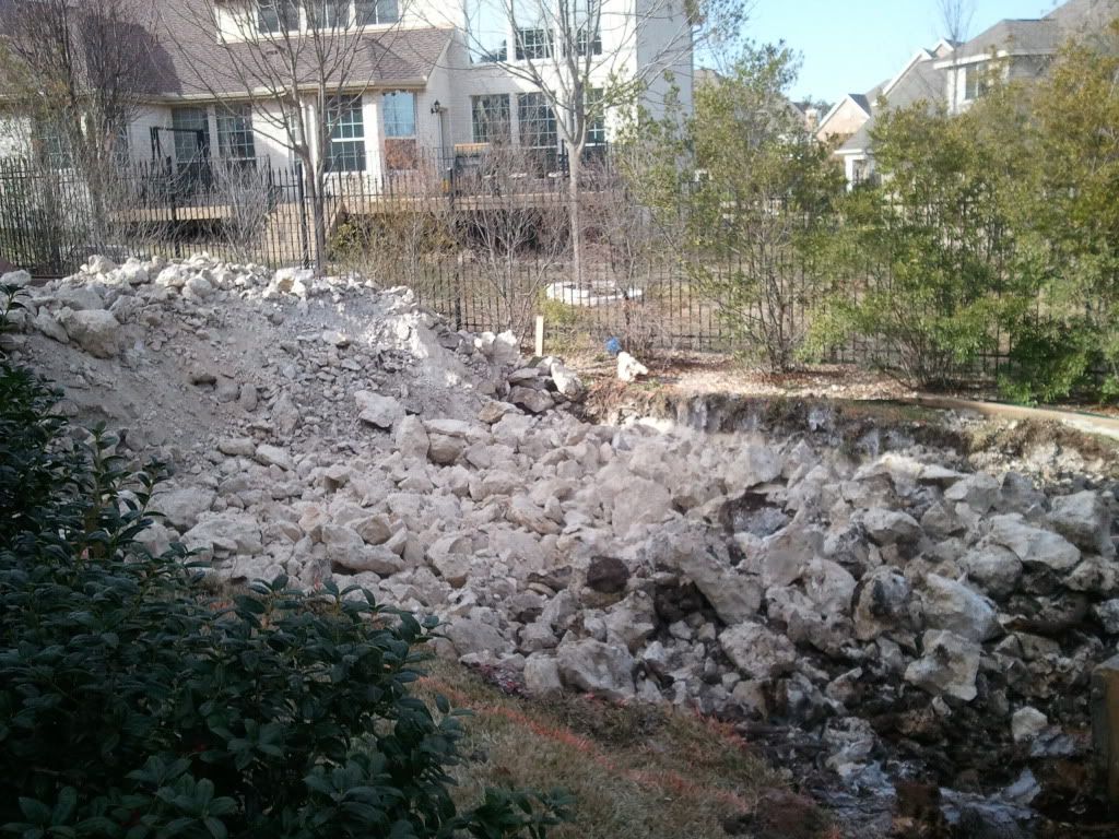

After 2 days of digging through solid limestone. They are about 3 feet deep
We are thinking about going with pebble sheen instead of quartz (1K cost) and dropping the UV system which I think is about 1K so it is cost neutral. From people that have experienced both, is pebble sheen easy enough on your feet compared to quartz? We will be doing a lot of volleyball, basketball and walking as the pool is a sports pool.
You can see how all our bushes died in the record drought. We were thinking about replacing them with clumping bamboo
RE: Texas pool build
Your feet won't know the difference and as the quartz ages, it gets rougher where the PS will keep going and going and going...
The ozone was wasted money anyway, IMHO.
Looks like they are using jack hammers on the rock.

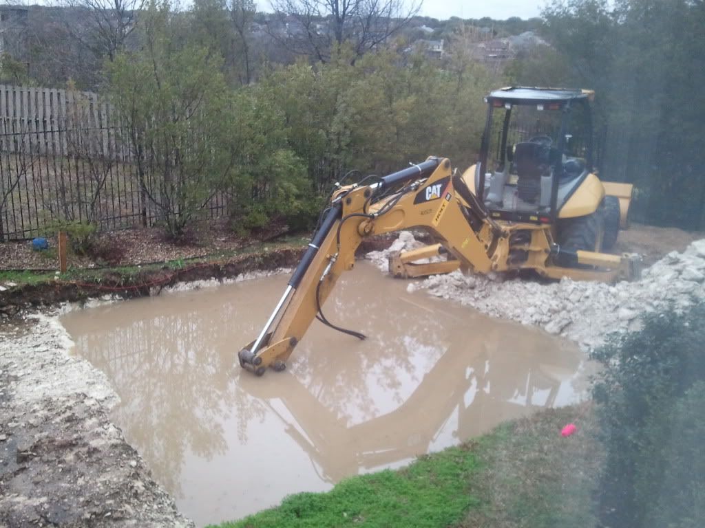

They are using a jackhammer attached to the back of a case 320 backhoe
They dug some more and cleared out all the rock. Then it rained.. more rain last night than we received all year. They have dug about half the length of the pool down to 3 feet, the rain completely filled it. The jackhammer attachment is completely submerged. I asked my wife if we could just stop here and have a natural limestone pool since the limestone seems to be holding the water...

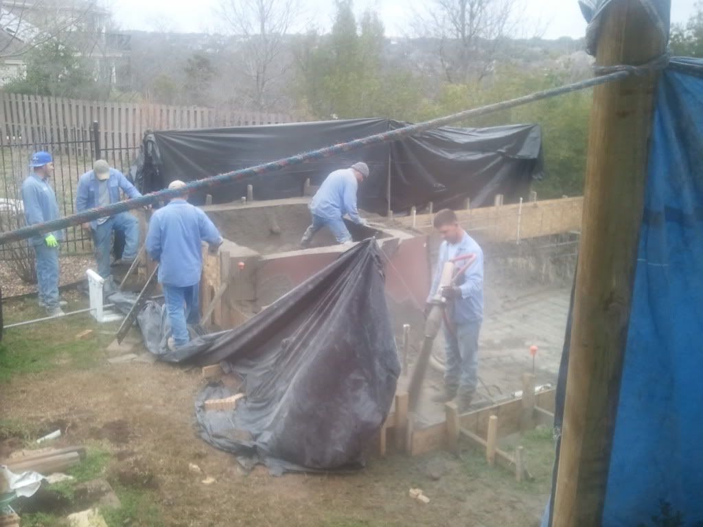

Gunite is going in right now
Gunite is done, it took about 7 hours
There is about 3 inches missing from the middle corner of the spa. They said it is easily fixed with plaster. Not sure why they didnt just gunite it.
From my limited experience, plaster follows the curves of what is already there. It can not be used to fill in large holes like that. The PB will probably use hydraulic cement. But being on the corner edge like that, it is strange that the shooters just didn't finish it off with gunite.
