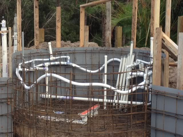

    BTW, copy and paste the third option, for this forum, will embed the pics. One per line please. White space between allows descriptions and allows a nice break between pics.
    I took the liberty to do the first ones for you. I also have a question below the last picture.
    The last picture has me a confused. Why are they using steel walls for the forms and not the earth?? Did they accidentally over excavate or was it intentional due to the soil conditions? This is a fairly unusual practice for a shot concrete pool.

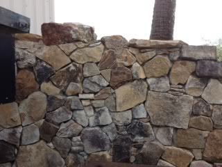

    Here are pictures of the stones we found today and plan to use in on our pool wall and spillway.
    Spillway Stone (zoomed out)
    Spillway Stone (zoomed in) - Minus the huge stone in the middle.
    Pool Wall & Top of Spa (we like the size/colors of stones on the middle to right side of this sample)

    The picture below is from Wednesday night after the pre-gunite plumbing was completed. We passed inspection, so we are ready for gunite which was delayed from Thursday to tomorrow (Saturday). Next week will be back-filling and grading the property followed by plumbing from the pool to the equipment location. After that we will be at a standstill until we finalize and get our tile and stone delivered. We will probably lose a week there.

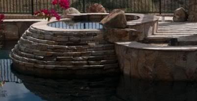

    The picture below is of a spillway I found on this forum from a couple of years ago. It was sdkath's pool. We are looking to do something very similar.

    I don't see any spacers between the steel wall and rebar. The rebar needs to be a couple inches off any form, be it earth or your steel wall or it does little if any good. This includes the floor steel too.
    The flex pipe appears quite saggy. That is sloppy workmanship. There must be 4" excess on the back side alone. Will it make a difference? I can't tell since I can't see the rest of the plumbing.
    What is the pipe along the bottom? It appears to be the same or close to the height of the drain.
    No blower? The venturis will be pretty loud.

    The flex pipe was sagging because it was pressurized when I took the picture. There are spacers between the rebar and the steel wall. Looks good. :)
