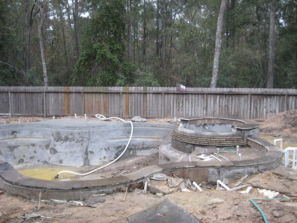

  • amy_texas

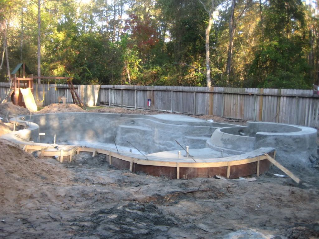

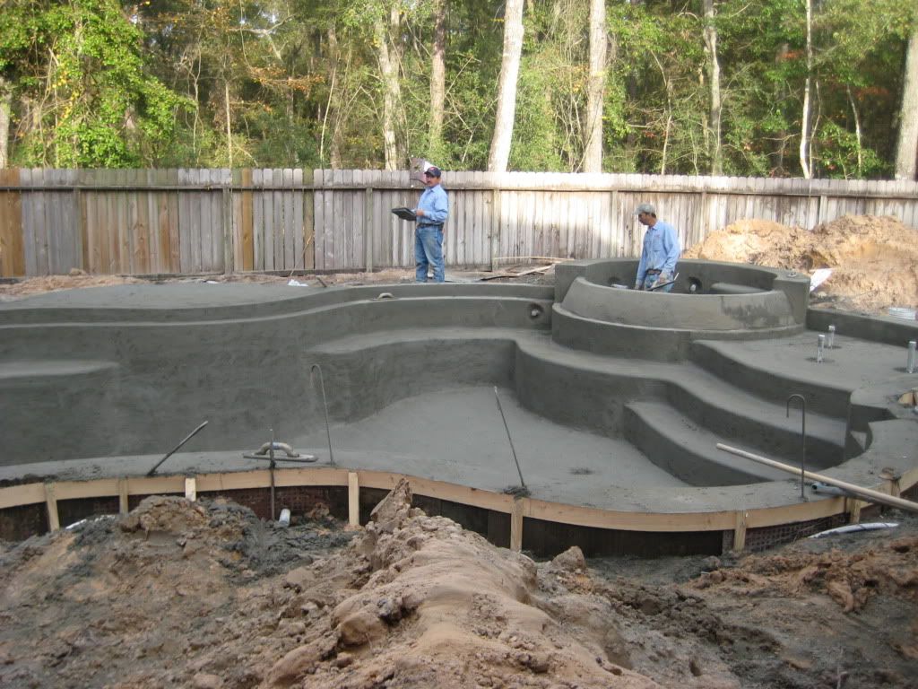

    14 years ago
    Rain, rain, go away...
    Because of the rain the last day we had any activity was last Thursday. The guys finished the coping and the tile; still have to complete the rest of the spillway and construct the waterfall.

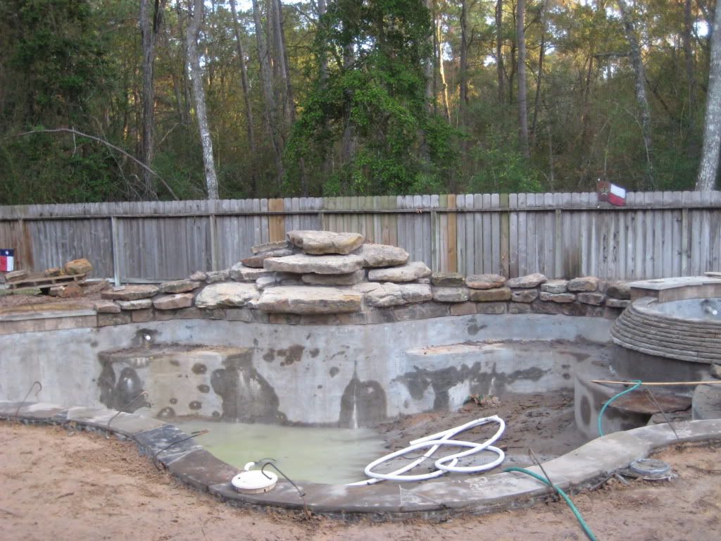

  • amy_texas
    14 years ago
    After almost one week, the guys came back to put the smaller base rocks along the waterline. Wednesday they began to build the waterfall. It got dark so they didn't finish. They were supposed to come back today but instead it is raining. Rain, rain, go away...

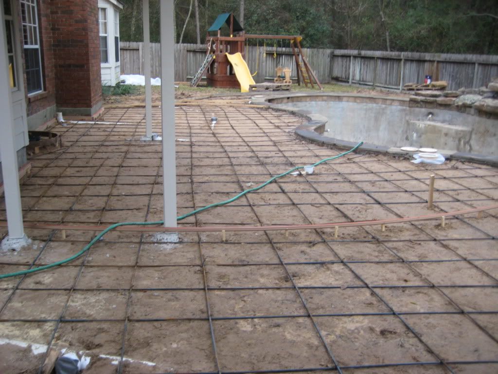

  • amy_texas
    14 years ago
    Now that we have had a couple of nice days, the waterfall and weeping wall are completed, spa is done, and the deck forms are down. We are thrilled with the look of the waterfall. The deck will hopefully get poured the first of the week and Pebbletec is scheduled for the Monday after Christmas.
    Here are a few pics of the work that went on yesterday.
  • amy_texas
    14 years ago
    The deck is getting poured today! Yea! Maybe it will be an end to all the dirt/mud we have been living with for the past month. Here are a couple of pictures this morning before the guys showed up.

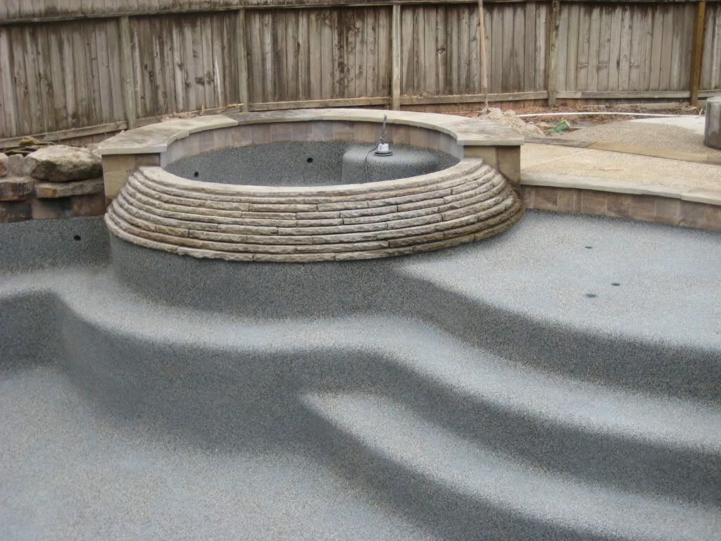

    14 years ago
    Pebbletec guys got done this morning before the rain moves in...yea!!! It looks great! Can't wait to see it after it is acid washed and water is in it. We went with Tahoe Blue and added the seashells.
    We also had gutters installed this morning. Just waiting on the stone guys to finish the inlays in the deck and put the flagstone on the firepit.

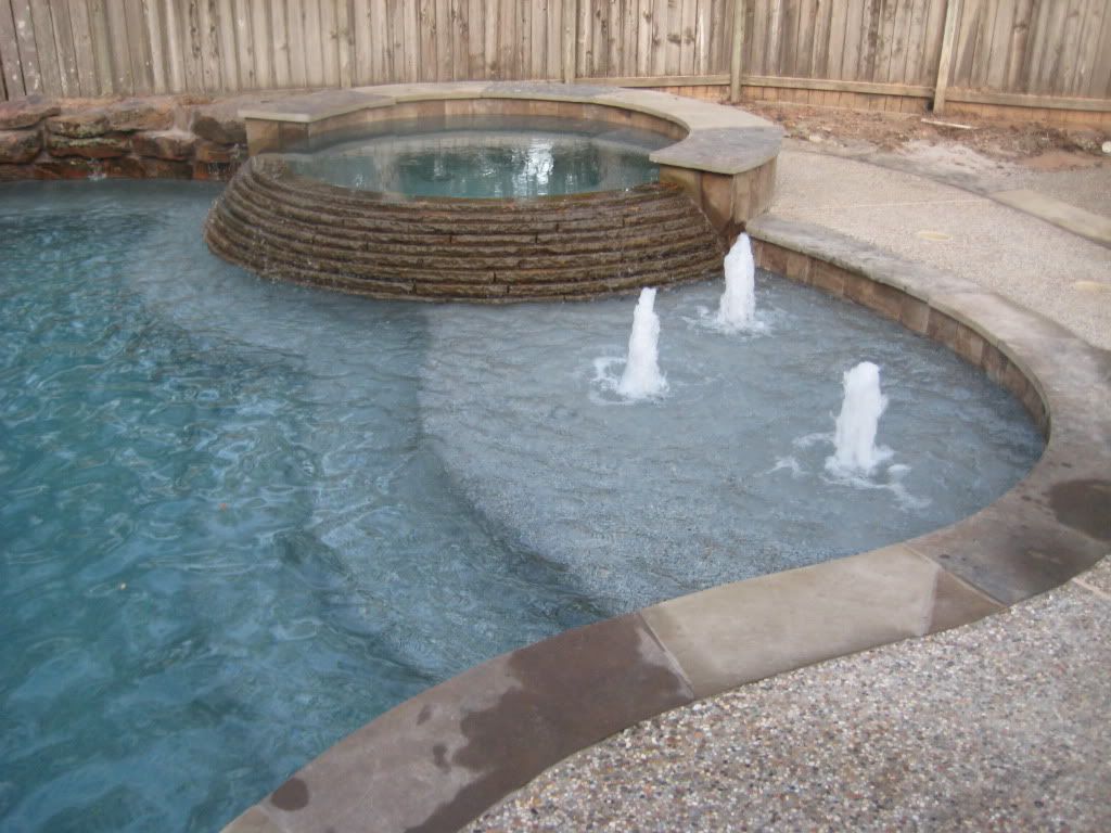

  • amy_texas
    14 years ago
    Thanks! We are absolutely thrilled at how it looks. Here are a few more pics now that we had the pool start up.
  • poolguynj
    14 years ago
    Be stingy using the W/F and bublers for the 1st months. It tends to raise the pH. The fresh plaster will do that too for the next several months. This is a critical time for your finish. Keeping the pH down to 7.2 to 7.3 will prevent scale. Getting it off new finishes stain free is sometimes more difficult.
    Sorry to sound like a party pooper.
    Scott
  • huskyridor
    14 years ago
    Scott's absolutely correct.
    With a low 7's PH, frothy water features will drop your Alkalinity slowly and raise the PH noticeably.
    Amy,
    Congrats, the new pool looks AWESOME!!!
    I'll try to get over as soon as I can.
    If the gas company gets there before I do, call me on my cell and I'll expedite hooking up the firepit.
    See ya,
    Kelly
