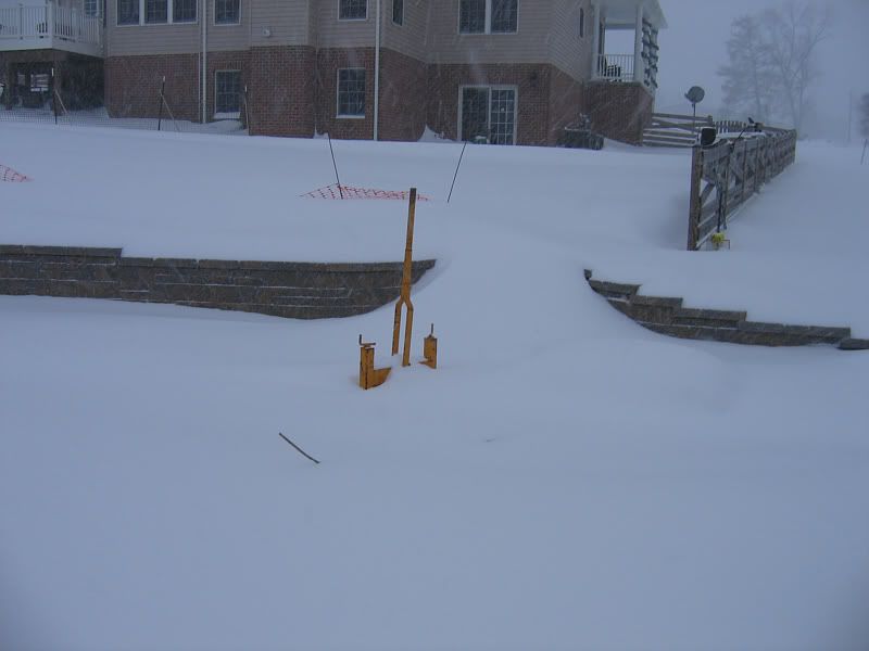

    Where our stairs will be in the wall:

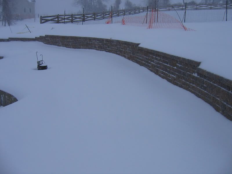

    Long view of the wall:

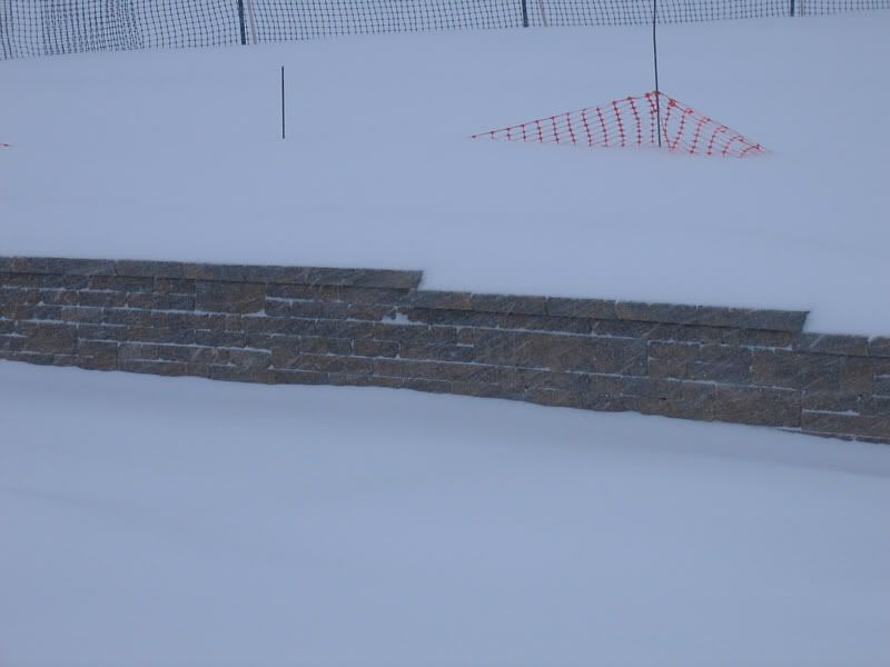

    Wall detail (amazing how stone-like it looks in the snow!):

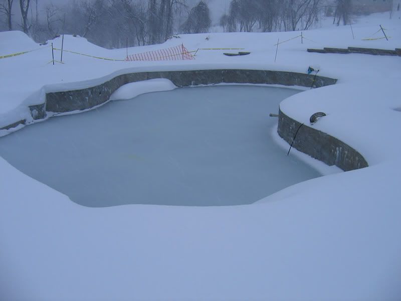

    And the pool itself:
