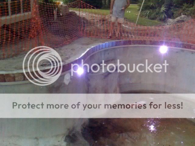

Electrician came yesterday and wired 2 lights. Foreman was out today to make sure the 3rd light was installed ~ after we brought it to their attention last night. Tile is finally in. They will come back tomorrow to grout. I'm sooooo glad that my husband talked me into changing the color. The metallic specks come to life when the light hits the tile.
Tile pic 2 - light picking up blue metallic specks

Are those three LED lights? And it may be just the photos, but the holes for the lights look to me like they are positioned (just below the waterline tiles) and sized for spa lights or for Nexxus Melody/Note?
RE: New Pool Build in St. Johns, FL
Yes...these LED lights are the Savi Melody by Nexxus Lighting.
Here is a link that might be useful: Savi Melody LED lights

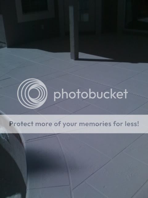

Base Coat for Acrylic Deck

Deck was finished yesterday. We met with the owner of the decking company a couple times and could tell he was a little skeptical about the pattern ~ although it wasn't very far off from what he has completed on other homes we visited in our area. We are very pleased with the finished product. The company texturized and patterned the spray deck exactly how we wanted - to look like ashlar slate. Here are some pictures:
Deck close up of texture
Finished deck

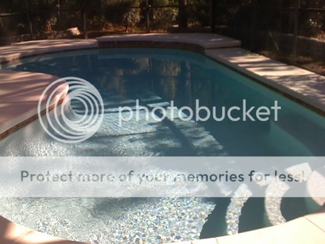

Pool with water Day 3 - pic 2
