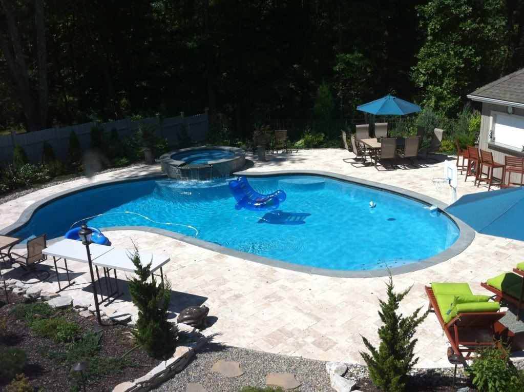

6 years so far, no sealer. Salt pool. Never sealed and all is well. Photobucket
RE: Travertine Decking
Beautiful. Thank you.
