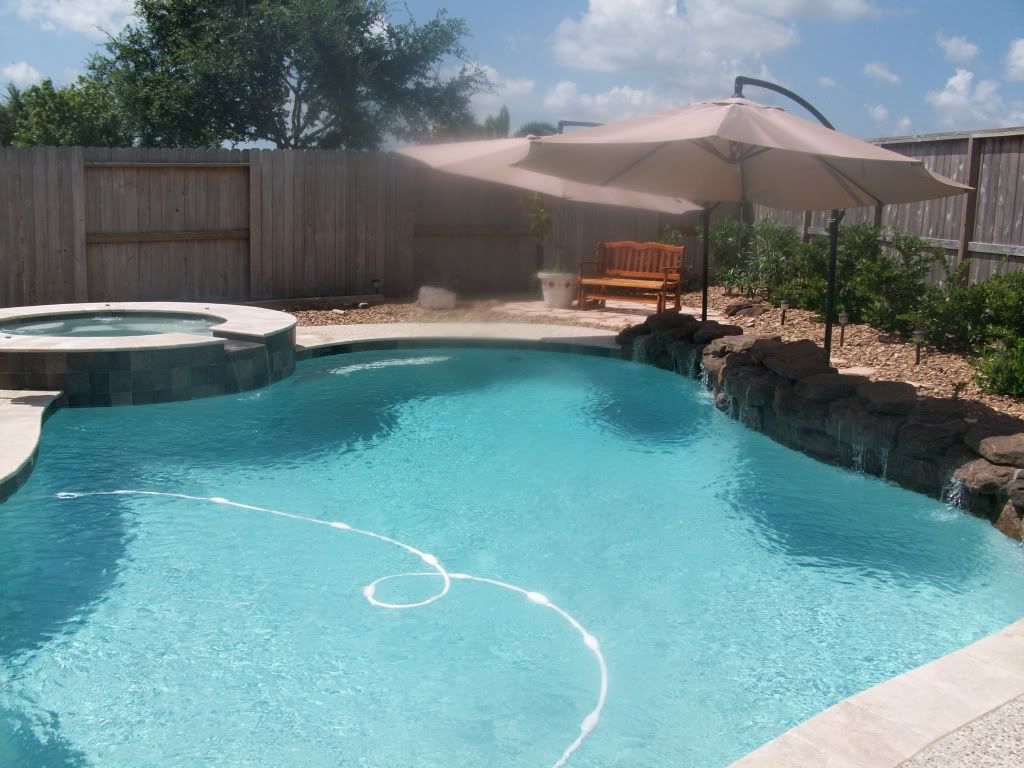

Here's my photo of Blue Pacific Coast sample, the color we chose for our pool:

Here's a pool (in Houston I think) finished in Primera Blue Pacific Coast: Houston Pool Renovations. A couple of interesting photos showing it being applied.
